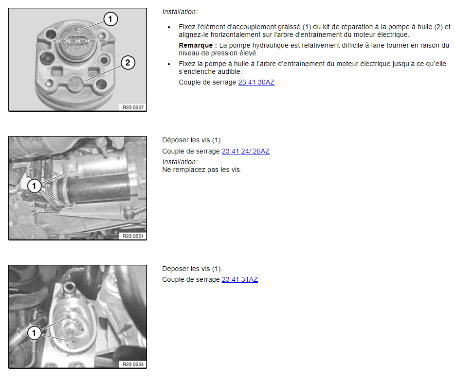

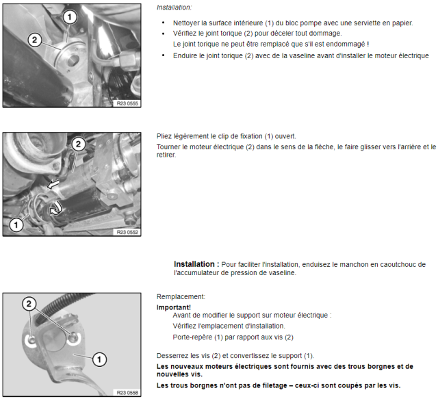

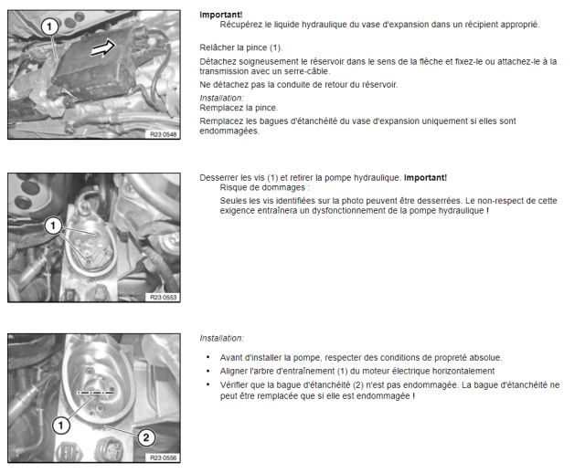

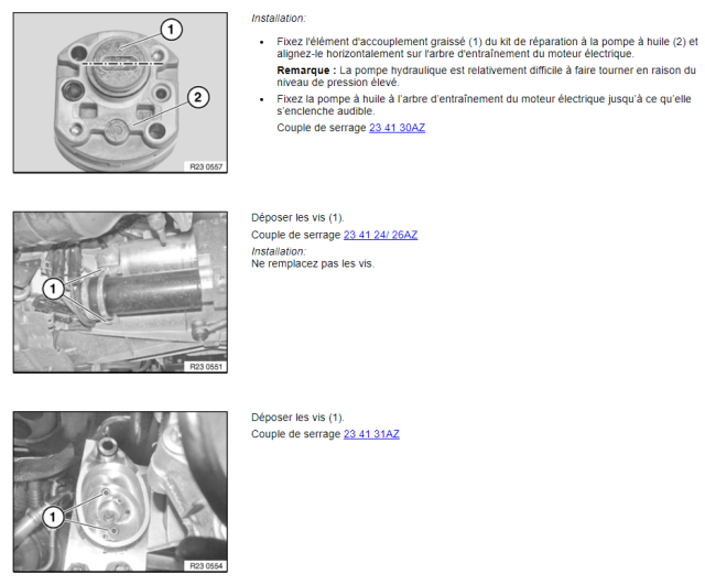

Posté(e) le 21 février 20241 a comment_1164583 Mon Anglais étant pas le must, Il explique un peu ton problème j'ai l'impression. De ce que je comprends c'est l'air qui bloquerait le bon fonctionnement de la pompe. Par contre l’explication n'est pas très clair pour moi ... Citation What happens is the suction line on the pump gets air bound inside the reservoir. I normally do them on the bench before installing to the transmission, without being attached to the actuator block. De-energized, the clutch valve is in the "vent slave" position, so pump discharge isn't going anywhere except pressurizing the accumulator. I take the rubber actuator return line and plug it with a spare banjo bolt and hose clamp. Install a slave cylinder and hard line to the pump block. Then, with the unit clamped into a vise with about a 5-10 degree down angle on the nose, connect power to the pump motor and run it. Using very low pressure air (max 30 psi), blow into the rubber check valve / vent port on top of the reservoir. Be very careful here, you can easily blow the reservoir off the back of the pump block. Just pressurize it a few times lightly and you'll hear the pitch of the motor change. Eventually, you force the bubble through the suction line and the pump will prime. I do this now with the bottom plug fully inserted as it makes a damn mess all over the workbench and floor. Only if it's really being stubborn do I back it out. The trick when installing a new motor, is one the motor is bolted to the block and the pump is bolted to the motor, hold the unit in a vise with the pump facing directly up. Fill the pump suction hole with CHF-11S using a turkey baster or similar and then just bump the motor with a power source and watch it suck the fluid down. Then fill the pump cavity to the brim and attach the reservoir. Once the reservoir is attached, rotate in vise t about 30 dégouté from horizontal and fill reservoir some. Make sure the return port is blocked off so it doesn't leak out there. Bump the motor a couple of times again and see if you hear it bog as the accumulator charges. Then rotate in vise again horizontal and finish filling and purging as above. Sinon voila ce qu'on trouve sur TIS a toi de voir si tout est en position Par contre d'après tis la remise en route est simple tu remplis le bocal que tu as réinstallé et zouuu... Alors que sur les US, ils jouent avec les vis de purge/depressurisation (celle sur le coté du bloc) Modifié le 21 février 20241 a par Babass

Posté(e) le 22 février 20241 a Auteur comment_1164795 Le 21/02/2024 à 09:15, Babass a dit : Mon Anglais étant pas le must, Il explique un peu ton problème j'ai l'impression. De ce que je comprends c'est l'air qui bloquerait le bon fonctionnement de la pompe. Par contre l’explication n'est pas très clair pour moi ... Sinon voila ce qu'on trouve sur TIS a toi de voir si tout est en position Par contre d'après tis la remise en route est simple tu remplis le bocal que tu as réinstallé et zouuu... Alors que sur les US, ils jouent avec les vis de purge/depressurisation (celle sur le coté du bloc) Super intéressant comme technique pour chasser l’air , je pense que c’est peu être LA technique pour bien purger dans mon cas où la procédure de démontage n’a pas été respecté Mon niveau anglais se situe uniquement a celui du traducteur de mon téléphone mdrr , les premières parties de ton message se traduisent pas très bien , en revanche le dernier paragraphe est très clair sur la technique de purge et le montage hors boîte À tout hasard t’arriverais à me donner le liens du sujet complet stp un grand merci Babass pour ton aide précieuse , samedi je vais faire cette tentative de purge et si ça fonctionne pas , direction plateau/transporteur pour l’amener chez un pro pour rectifier ma bêtise
