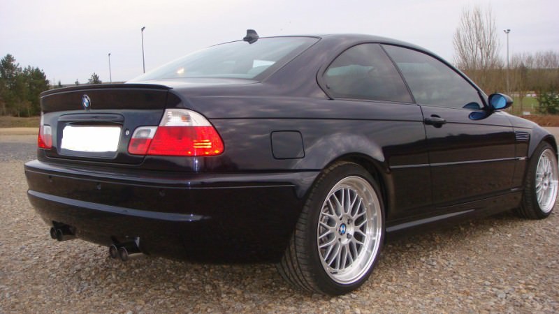

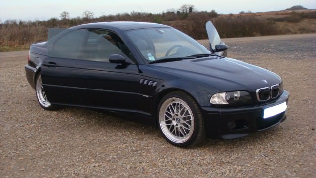

tu connait tes ET ??? :nickel:
BBS LM :
AV => 19x8.5
Offset: 32mm
Backspacing: " Bolt Pattern: 5-120
Rec. Tire Size:245/35-19
Weight: 24.5lbs.
AR => 19x9.5
Offset: +32mm
Rec. Tire Size:275/30-19
Weight: 25.0lbs.
Ou AR => 19x10
Offset: 25mm
Backspacing: 6.5"
Bolt Pattern: 5-120
Weight: 25.5lbs.
Ou AR => 19x11
Offset: 25mm
Backspacing: 6.5"
Bolt Pattern: 5-120
Weight: 28.3lbs.
comment_215864
a l arriere je suis obliger de mettre de calle de 15 mm pour que ce soi comme l origine
