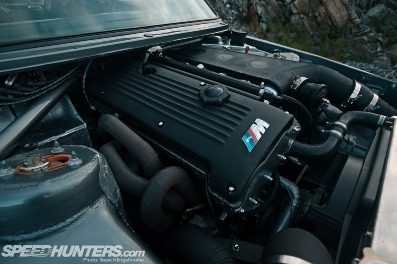

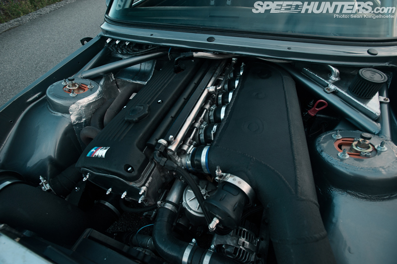

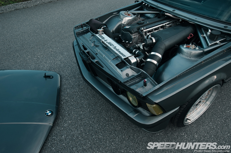

ENGINE
3.2L turbocharged S54 engine; CP 9:1 pistons; Pauter X-profile rods; ARP I19 head bolts, 2000 cam beraring bolts; head overhaul with OEM components; JAAS VANOS block off, headers, intake manifold, throttle cable conversion, intercooler piping, exhaust manifold, exhaust, muffler; PTE 7654 billet turbo; 60mm PPF wastegate, 75mm blow-off valve; BOSCH 1680cc injectors, 044 fuel pump (x2); NUKE fuel rail; 40L fuelcell; electric water pump; VW LT fan; Griffin aluminum radiator, Intercooler
ENGINE MANAGEMENT
Electromotive TEC GT ECU

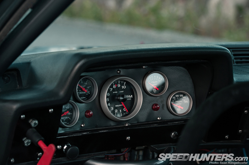

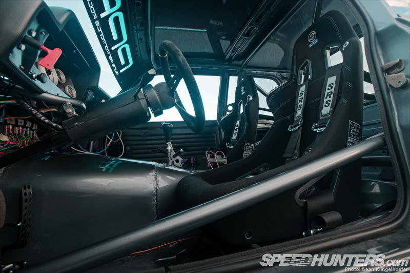

Sparco Sprint seats; SRS 6-point harness; Sabelt steering wheel; Autometer Sport Comp tachometer, oil pressure, oil temperature, water temperature and boost gauges; hydraulic hand brake; floor mounted pedal set
BODY
Firewall moved 30 cm, larger custom transmission tunnel, compete roll cage welded to shock towers and rear sub frame mounts, rear fenders 4cm wider, custom trunk floor; yellow film on E34 headlights and blinkers

J'adore!! Ils ont rentré le s54 au chausse pied en plus.
