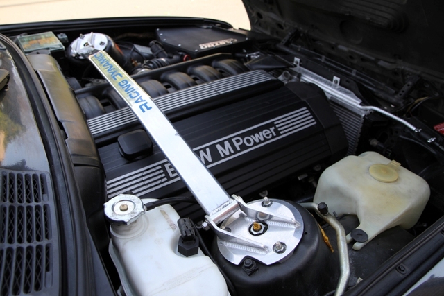

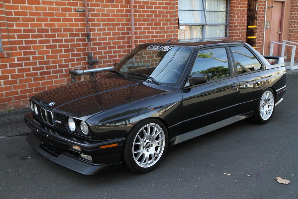

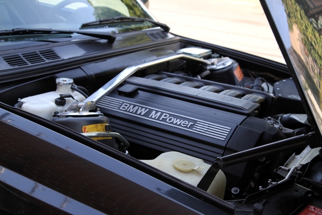

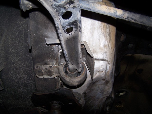

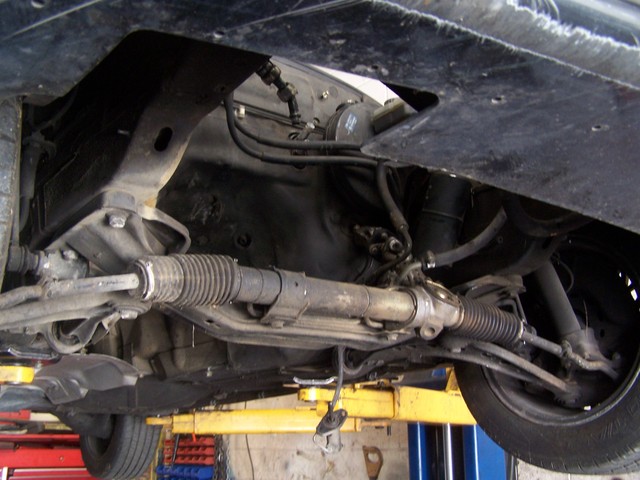

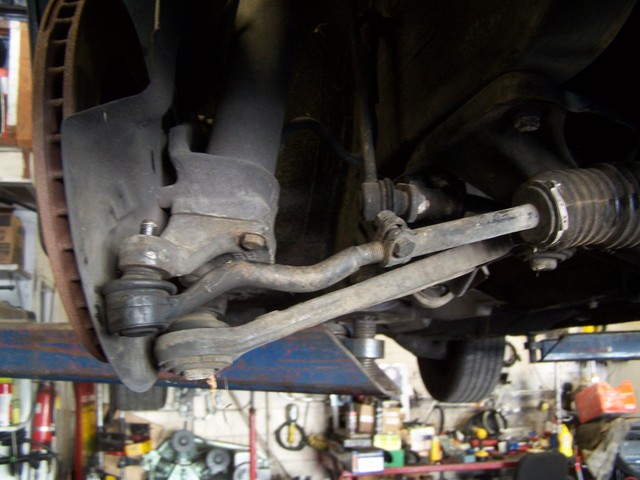

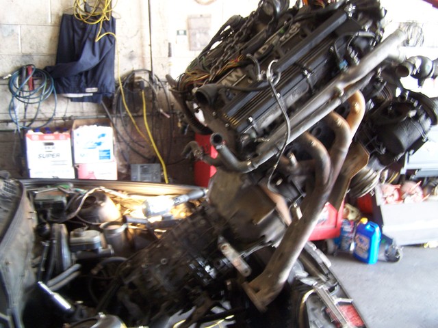

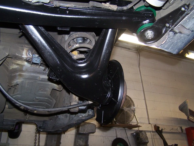

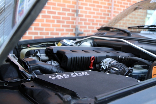

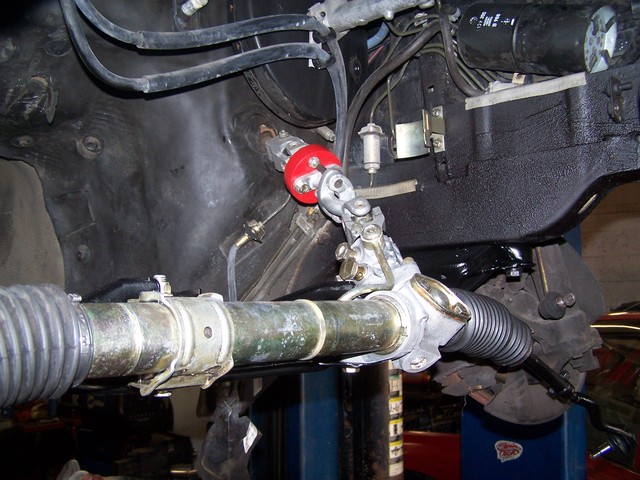

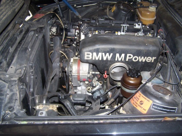

Une autre petite M3 E30 ayant subie une greffe de coeur dans les règles de l'art :)
Moteur -
S50b30 engine swap venant d'une M3 de 1995
Castro Motorsport Short Ram intake + Airbox
s52 tubular exhaust manifolds
Custom dual 2.25" mandrel bent exhaust built by Castro Motorsport
Custom dyno tune for the listed modifications
Drivetrain-
Matching ZF310 5 speed transmission
2.93:1 LSD
F1 Racing Stage 1 clutch
F1 Racing lightweight flywheel
Ralco short shifter
Suspension & Steering-
Custom coil-overs - 650# (F) / 800# ®
Koni top adjustable shocks front and rear
Ground Control Camber-Caster plates
Ireland Engineering 22mm front/ 19mm rear swaybars
Ireland Engineering polyurethane rear trailing arm bushings
Ireland Engineering polyurethane rear sub-frame bushings - race compound
Racing Dynamics front strut brace
95 M3 Steering Rack
Ireland Engineering polyurethane steering coupler
New OE M3 offset control arm bushings
New OE M3 sway bar links - front & rear
Wheels & Tires-
Staggered offset 17x8.5 BBS CH: et38 front with 20mm spacer, et15 rear no spacer
235/40/17 Federal 595RS
Brakes-
Factory brakes
New Pagid pads
New Brembo blank rotors
Ireland Engineering stainless steel braided brake lines
Ate Superblue performance brake fluid
Place aux photos!
Malheureusement les autres photos de la préparation ont été perdues

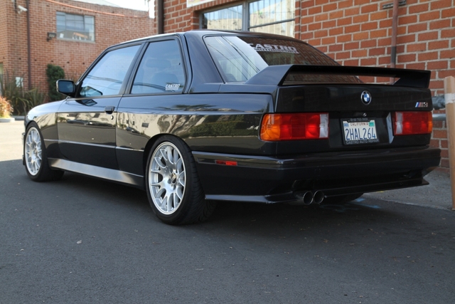

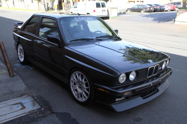

Photos finales de la voiture
comment_508125
:lover:  :lover:  :lover:  :lover:
Encore du grand Mendez sauf les jantes…
Merci !
