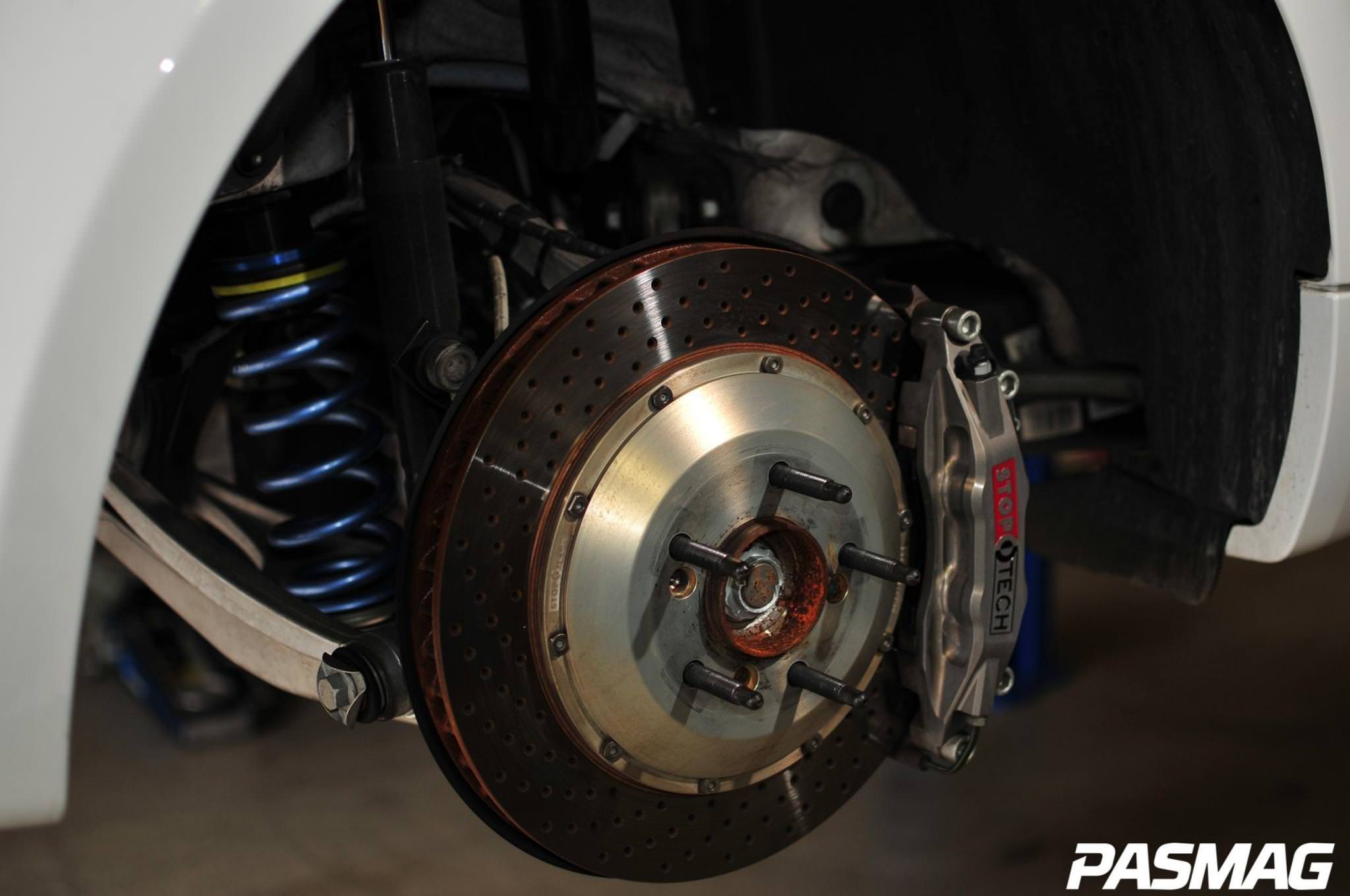

To set the corner balance, Lin matched up Swift springs with an Ohlins Road&Track single-adjustable coil-over DFV shocks and Vorshlag camber plates. “The combination of Monotube dampers and DFV technology give the R&T coil-overs a Dr. Jekyll and Mr Hyde personality with a few simple clicks of the adjustment knobs.” At the rear Lin has added his own quick-change rear spring kit (the rear springs directly control rear tire grip and need to be swapped to better match track conditions). All of this with the aim of destroying lap times. In other words, with these changes and the aggressive Michelin Pilot Super Sport tires (255/35R-19 front and 275/35R-19 rear) Lin has wrapped around BMW Competition Package wheels, the 1M's cornering grip has improved into the stratosphere without appearing much différent from stock. To fully realize its potential requires a track, a helmet, and a fully-qualified driving instructor. Yes, it's that good.
While the stock brakes were very capable units and matched to the grip of the OEM tires, Lin stepped up to a massive Stoptech Trophy Sport package. The forged aluminum STR calipers are lighter than stock, the two-piece full-floating AeroRotors are lighter and cool more efficiently, and each caliper's center bridge stiffener can quickly be removed for rapid pad changes if needed. They're designed to handle the weight of the full-size M3 and represent a fanatical level of overkill for the typical 1M. Bear with us though as we're about to establish why they are completely necessary on Lin's creation. A stock 1M busts out a very generous 340 horsepower at the flywheel from its twin-turbocharged N54 during the full-throttle overboost cleverly built into the ECU software. Aren't dual turbos and computer-controlled waste-gates grand? Lin's weapon of mass destruction spins the rollers at just over 390 at the sticky rear tires, which equates to about 440 at the flywheel. Significantly more than the V8 M3 can muster. Those bigger brakes are not for show.

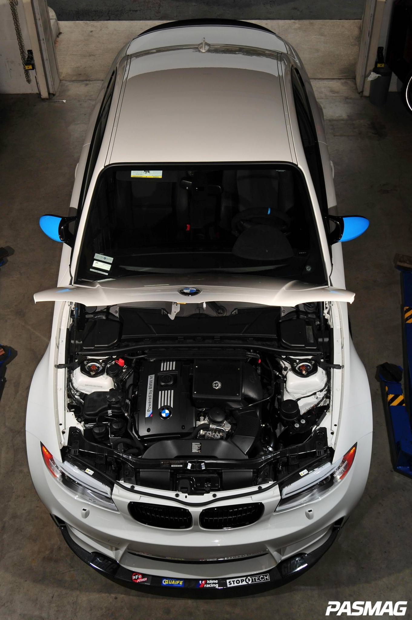

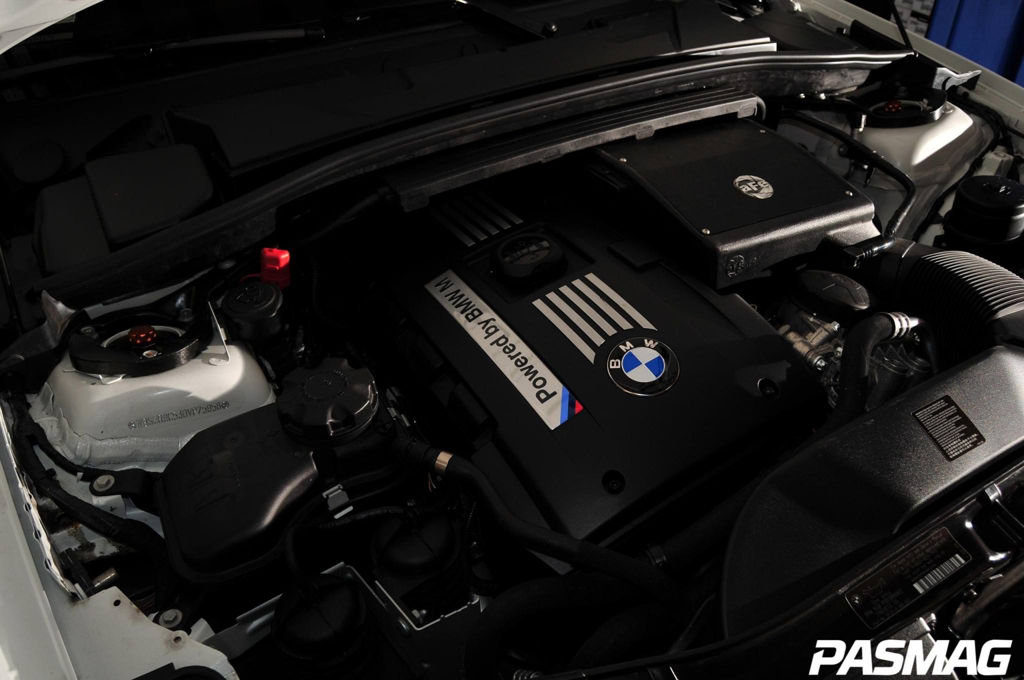

In preparation for more boost, Lin upgraded the front-mount intercooler to one from Forge Motorsport, which combines a thicker, more efficient core with direct-fit couplers, creating a factory level of attachment security. Air inhalation is courtesy of an AFE Stage 2 intake with dual air scoops. The consumed gases exit through a Mad Dad mid-pipe and a Borla axle-back exhaust. The charge pipe comes from Evolution Raceworks and holds a TiAL blow-off valve in place of the basic unit from BMW. What makes the magic happen is a GIAC Stage 2 flash program for the ECU, with the Race Fuel Map option and a hand-held switcher. There's a solid one hundred ponies and eighty foot-pounds of torque waiting to be released from the N54 with these few engine tweaks. Adding larger turbos could boost it farther, but folks, we've got to assure you that this 1M is a rocket.

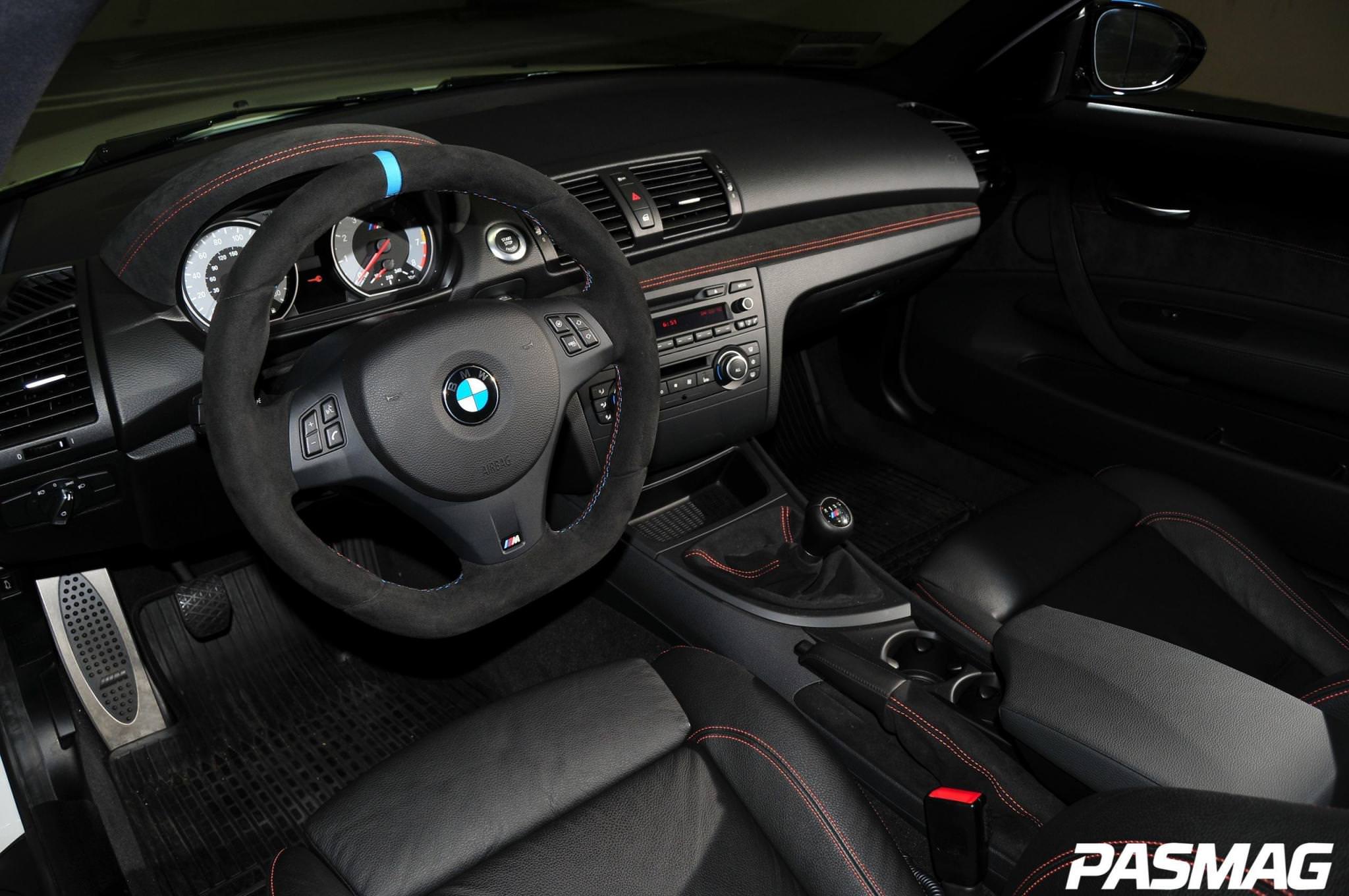

One of the points BMW got very right is the six-speed manual transmission. While their dual-sequential gearbox is very nice there's just one thing it does not do well; it won't coast. The sequential box always has a gear engaged, whether you're on the throttle or off of it, and that can affect the grip the rear tires have. The 135i only comes with the DSG transmission, and it makes the fastest corner-carving entry-level machine we've ever witnessed but, it cannot hold a candle to the 1M. Rowing the gears, sensing each gate snick into place in typical German fashion, and feeling the quicker M3 hydraulic clutch delay valve slam the disc against the flywheel should be a right of passage from boyhood to manhood. Fun is mandatory, tire smoking launches are optional. Mastering up and downshifts, feet dancing on the Ultimate Clutch Pedal Lin installed, whilst controlling super-precise steering and a hyperactive throttle is what makes driving a sport. If it wasn't difficult, then we'd all be the second coming of Juan Manuel Fangio, and clearly we're not. Lin's BMW Competition steering wheel entices you to throw down the cell phone, turn off the radio, grab it with both hands and wrest the most amazing experience you've ever had in a car out of it before the cops find you and arrest you for breaking every automotive statute on the books. Maybe it's a good thing BMW sold so few of these in the U.S. after all.

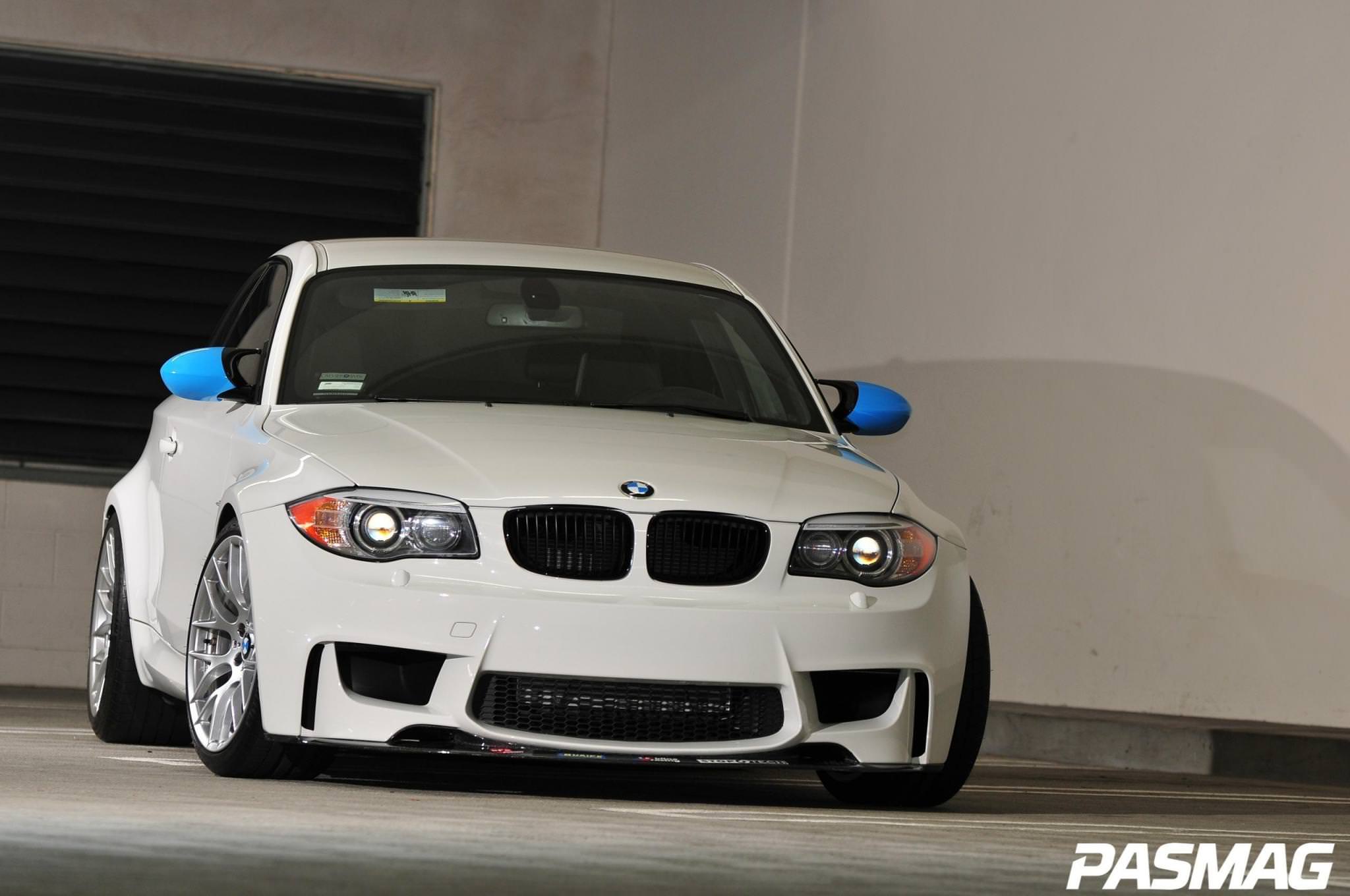

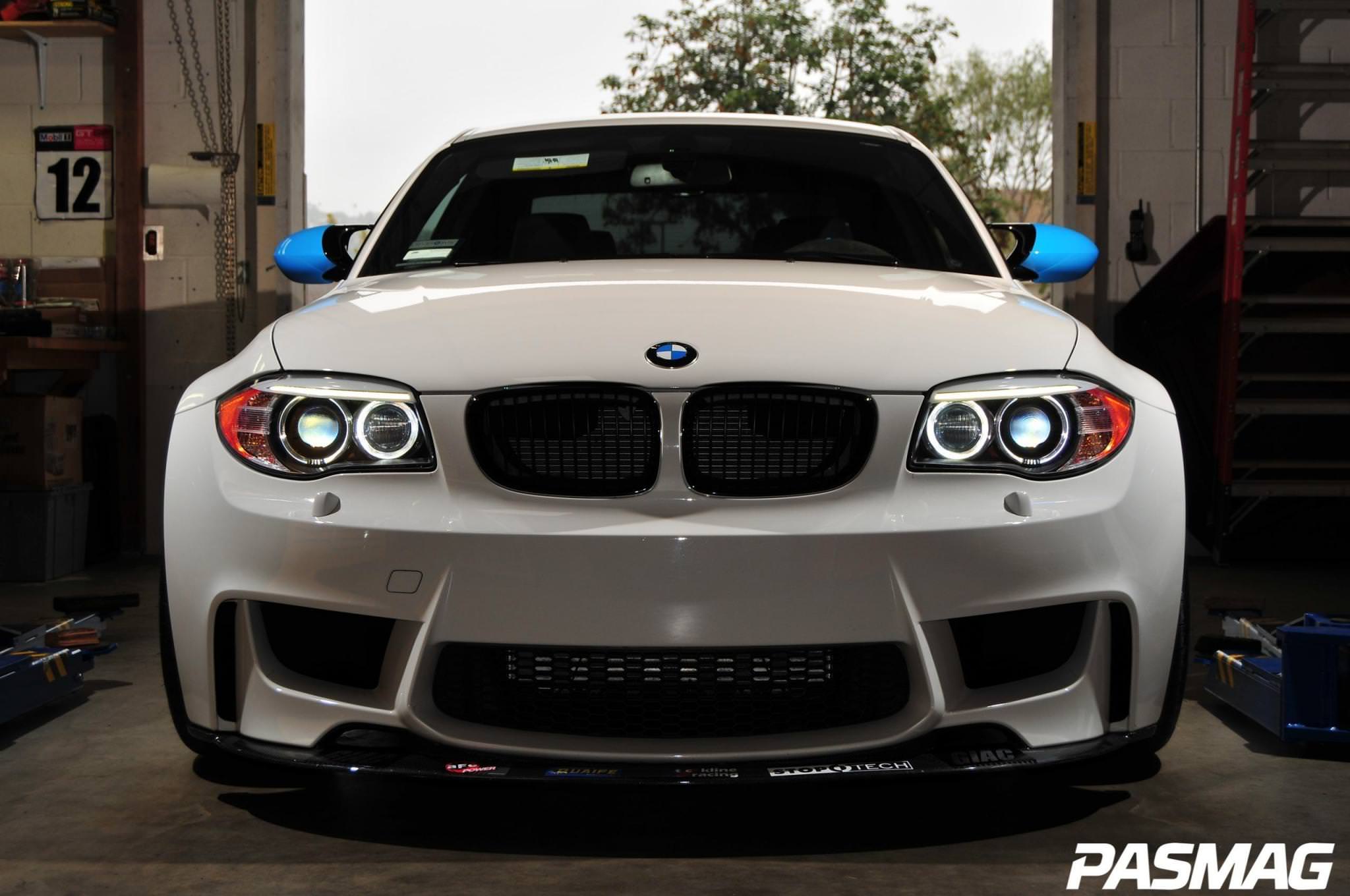

As stock as its white exterior appears, Lin did add some subtle touches, like the BMW Performance blacked-out grill. The rear trunk lid is topped by a BMW carbon fiber lip spoiler. He's also installed a SleK carbon fiber front splitter and a Borla rear diffuser, which is perhaps the biggest tell of all; high speed stability (anti-lift) aides should always be a warning to the uninitiated. Well, those and the monstrous brakes, and the sticky rubber...

Elle est top avec ce rappel de bleu sur les rétroviseurs et le volant !
C'est effectivement très bien écrit :) Et pourquoi on doit avoir une plaque à l'avant nous ? C'est tellement beau sans rien ...
C'est vrai que sans plaque c'est plus jolie :nickel6:
par contre le bleu sur les rétro je suis pas fan... aprés si on me la donne comme ça je prend of course :perenoel:

J'aime bien la lame avant en carbone, elle reste discrète. C'est quoi comme marque on peut la trouver où?

Le bleu sur les rétros c'est pour les protéger, ça se retire, en trackdays ils mettent souvent ce tape de protection bleu sur les phares et/ou les rétros.

Oui il y ressemble beaucoup Merci!! Mais je suis pas prêt à mettre 1000€ dans une lame en carbone...

ce serait pas mal avec des haricots de calandre et un béquet arrière bleus, mais pas plus, déjà les rétros au milieu de tout ce blanc, on voit que ça
par contre les autocollants sur la lame...
comment_616297
Elle est super; "discrète" et afficace. Pour les autocollants il faut faire de la pub aux équipementiers.
