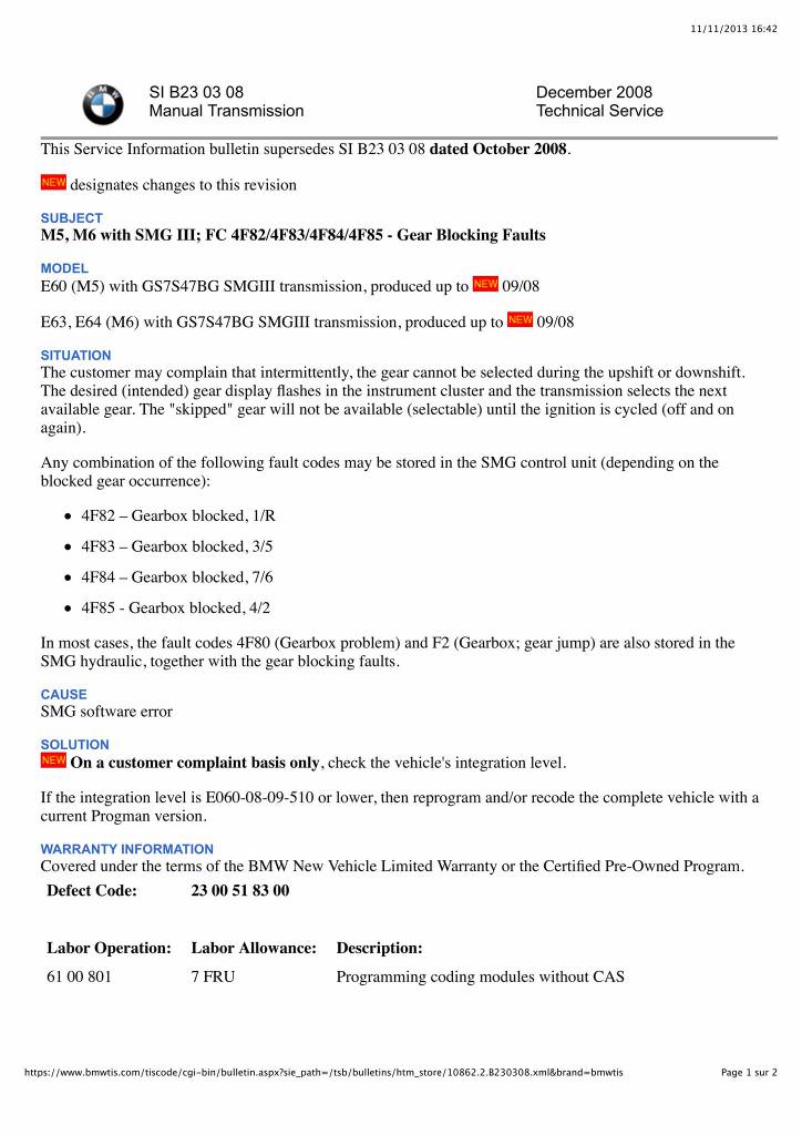

SI B23 03 08 - M5, M6 with SMG III; FC 4F82/4F83/4F84/4F85 - Gear Blocking Faults
