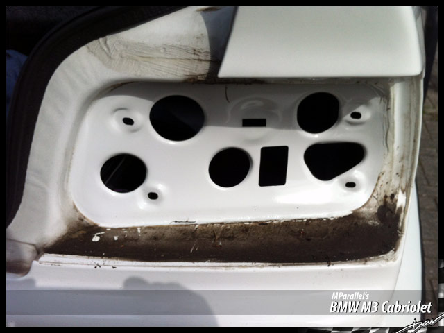

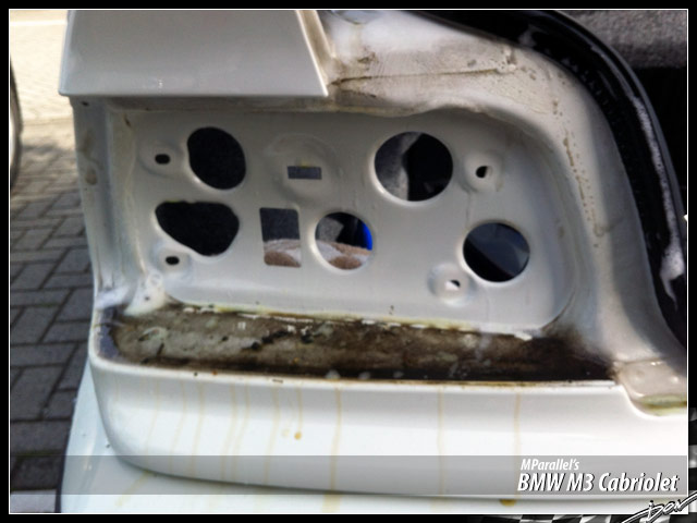

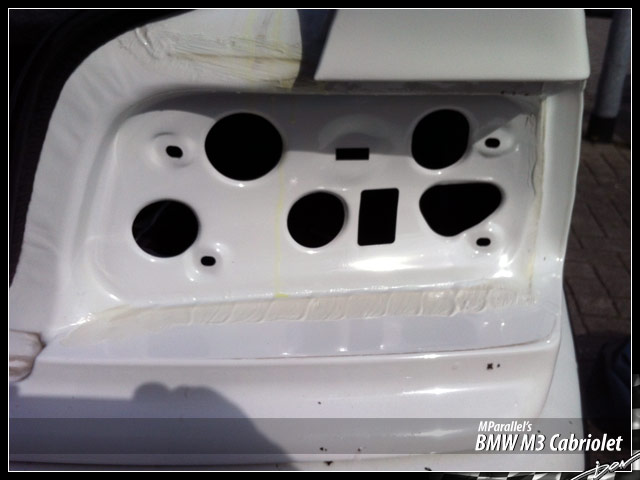

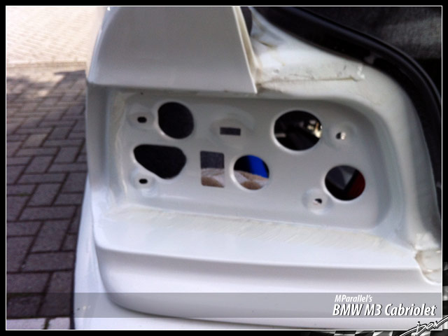

Exactly. Since I had to swap between tail lights a few times, I also saw that there's water ingress and stagnation behind the light. Whatever the condition of the joints that surround the lights. Since these are fairly easy to take off, or let's just say very easy (otherwise I wouldn't be able to do it :W) it's nice to clean behind them a few times per year. I used to put a pair of desicants bags near the spare wheel as well.

Oui, et comme je dis en rosbeaf, hésites pas à virer les feux et nettoyer derrière. ça se rempli vite de merde humide, et celà en quelques mois seulement. J'avais aussi mis une paire de gros absorbeurs d'humidité en sachet dans le coffre histoire de...
Luckely I have no water ingress behind my taillights, but you always have dirt/moisture build-up between lights and body.
Once a year I take them off and clean all the dirt.
