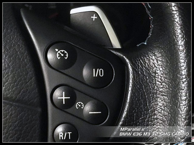

It's not really maintenance, but in my opinion, the best modification you can do to SMGI, almost mandatory: paddle shifters. Makes it so more enjoyable to drive.
