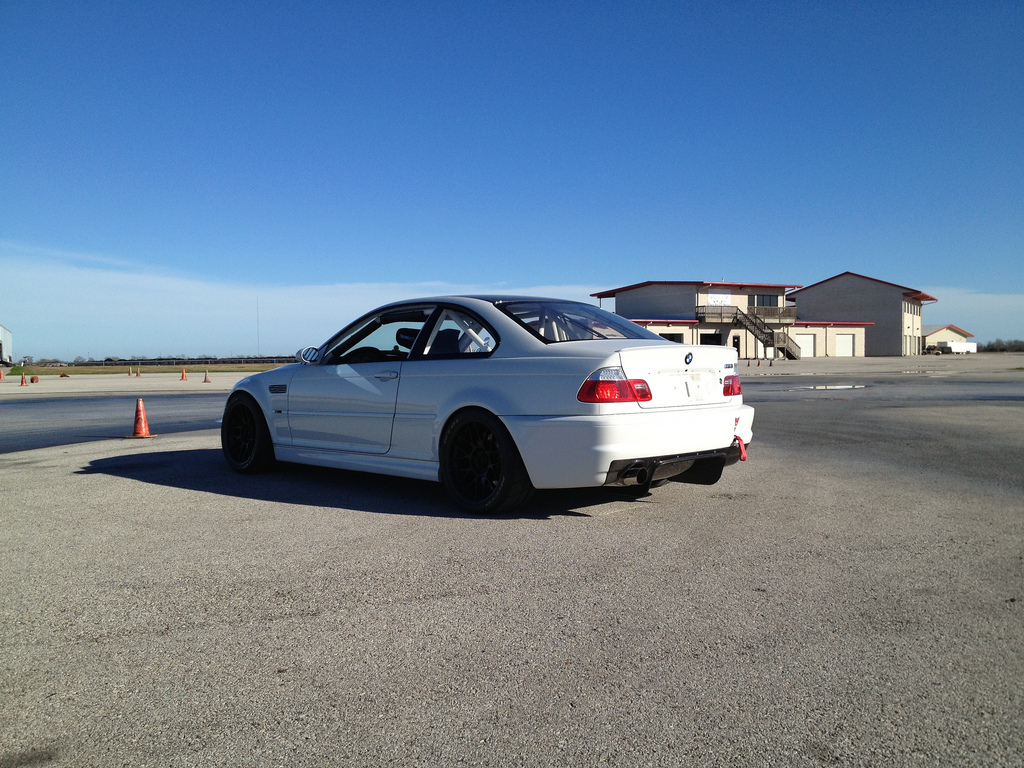

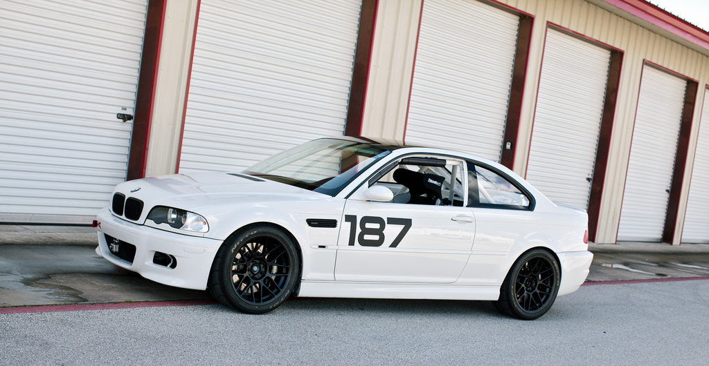

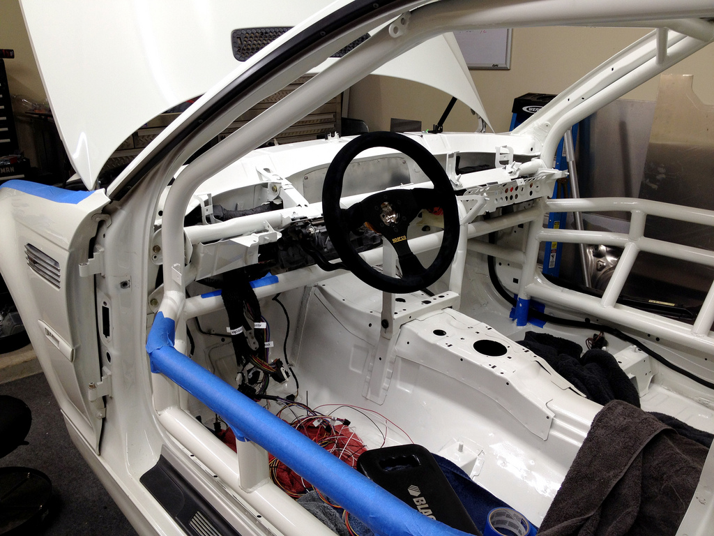

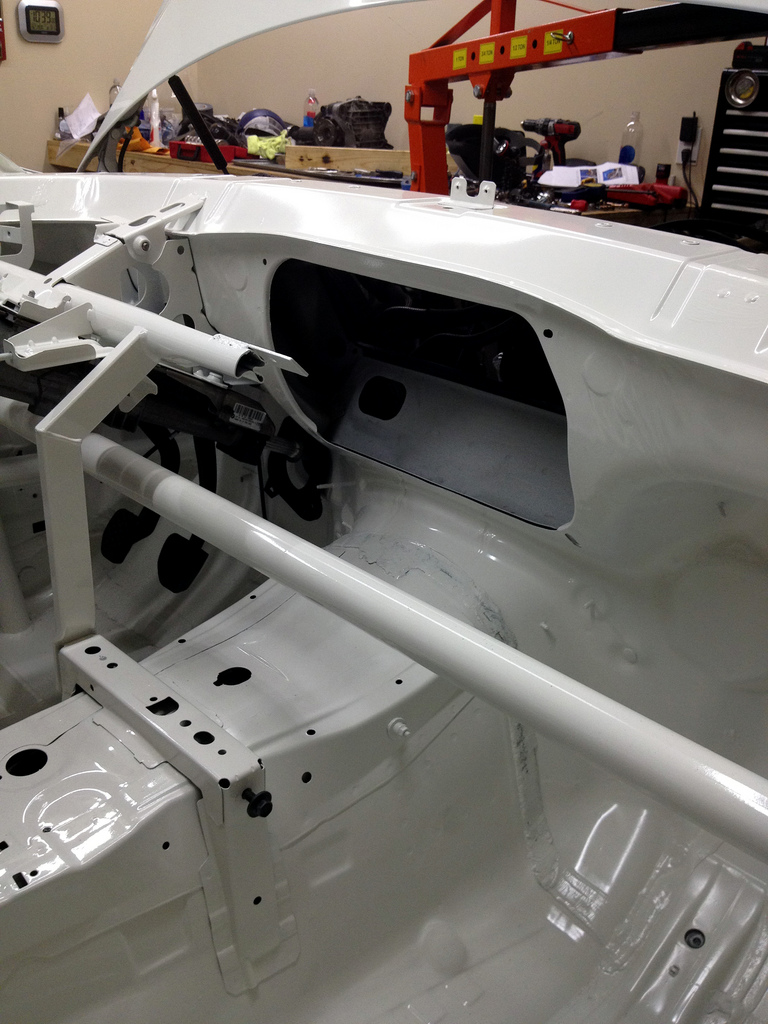

M3 E46 - Du très très lourd!

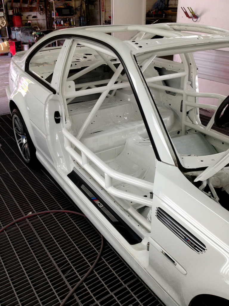

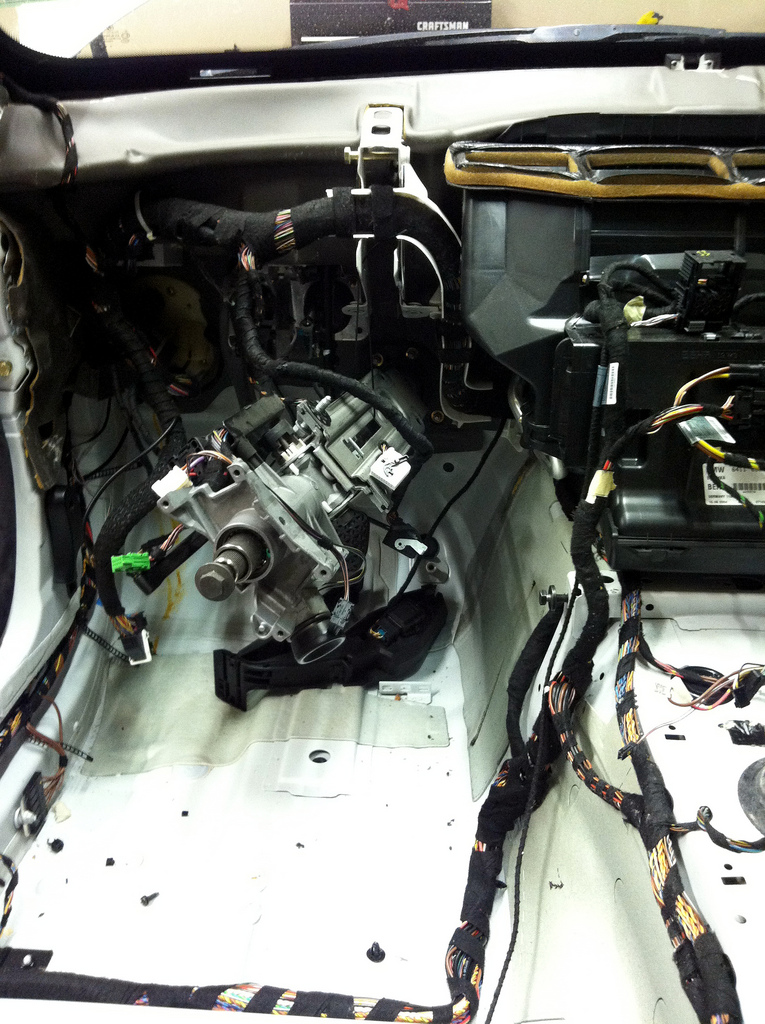

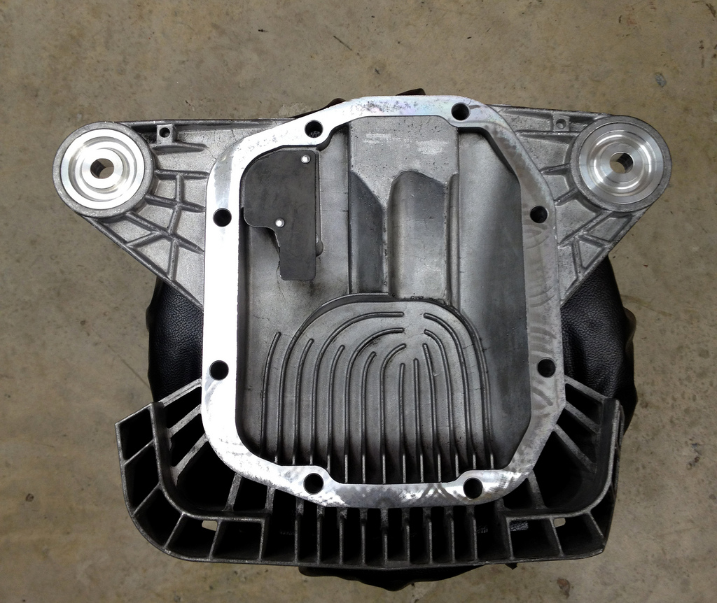

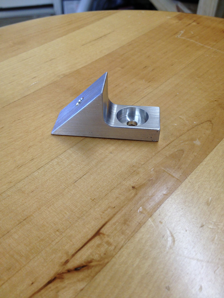

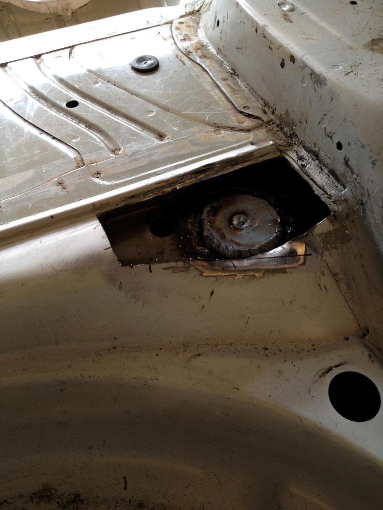

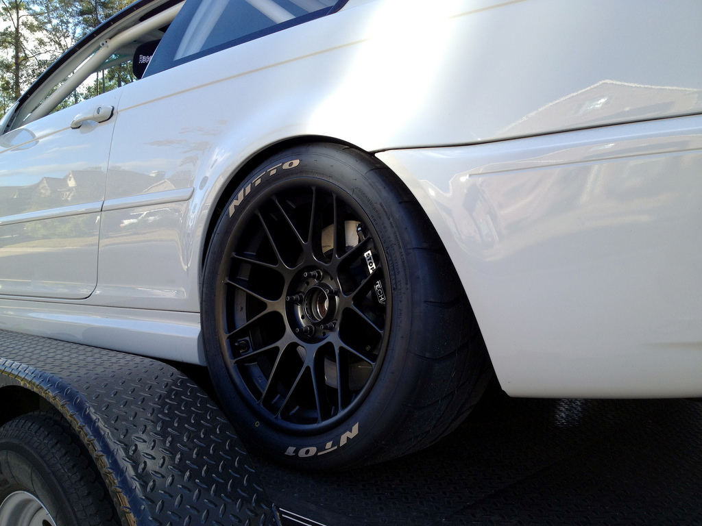

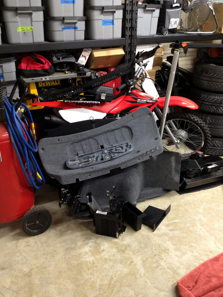

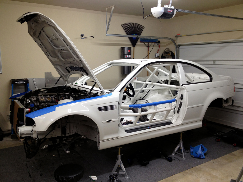

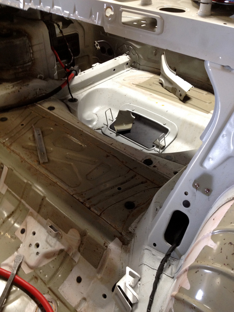

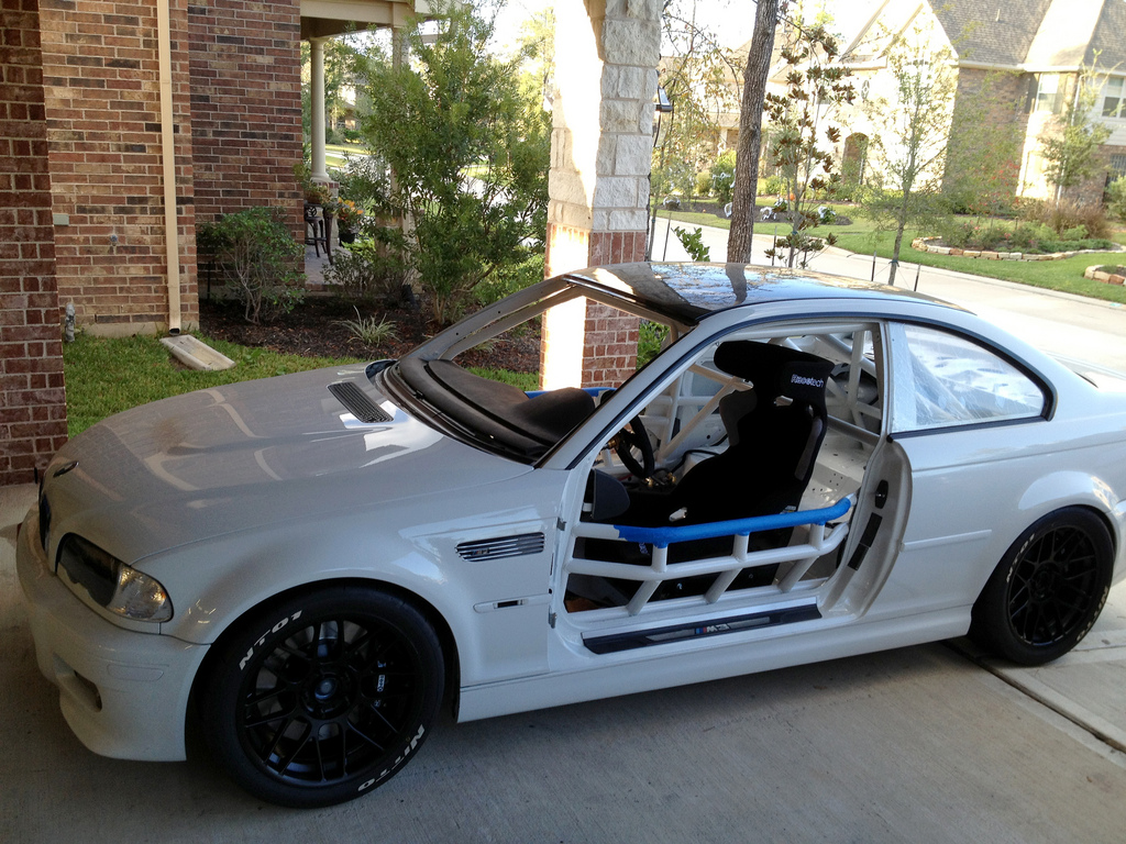

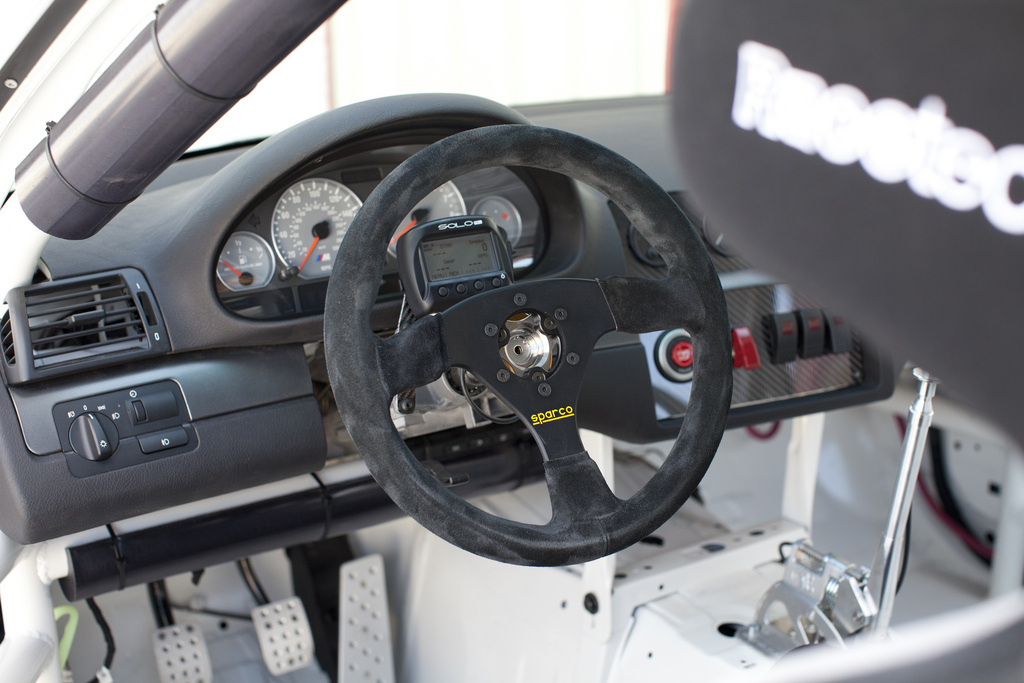

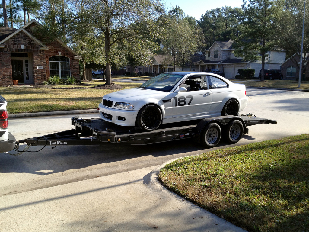

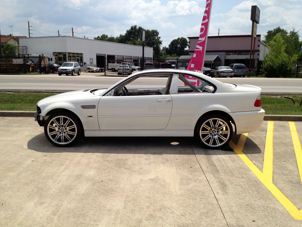

Je vous propose le construction étape par étape d'une M3 E46 de course par un privé.
Le boulot et la qualité du travail sont juste hallucinant!
Parts/Modifications Section (Top Level)

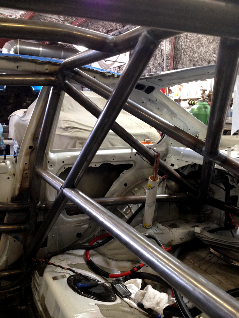

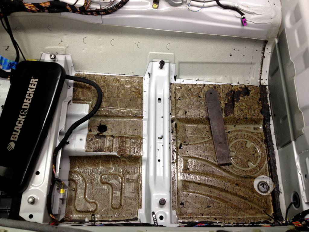

Body

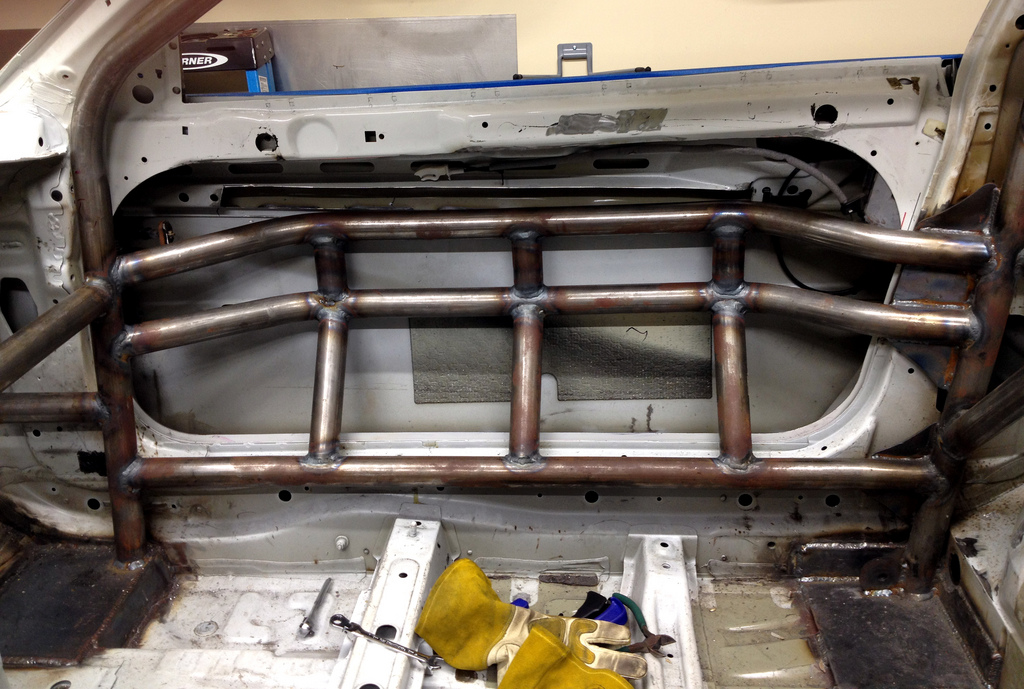

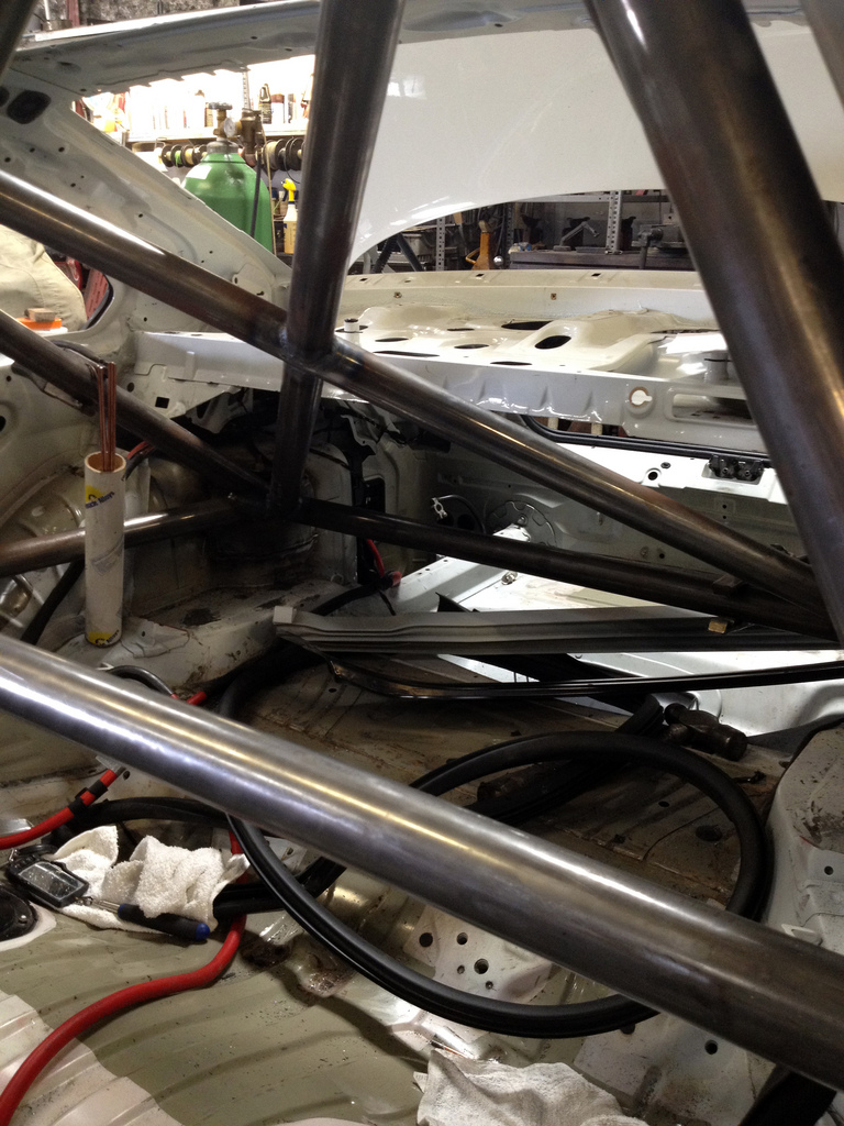

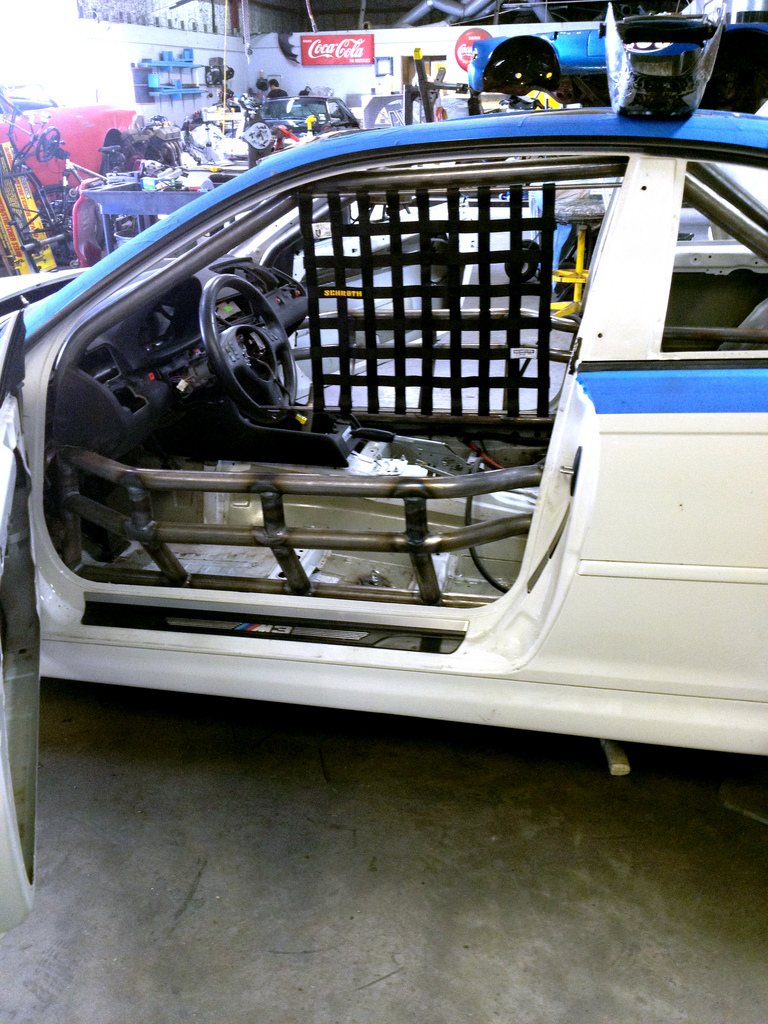

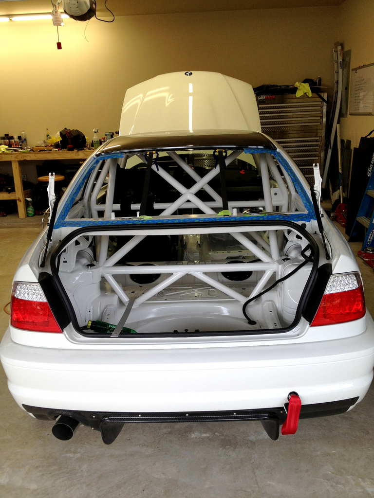

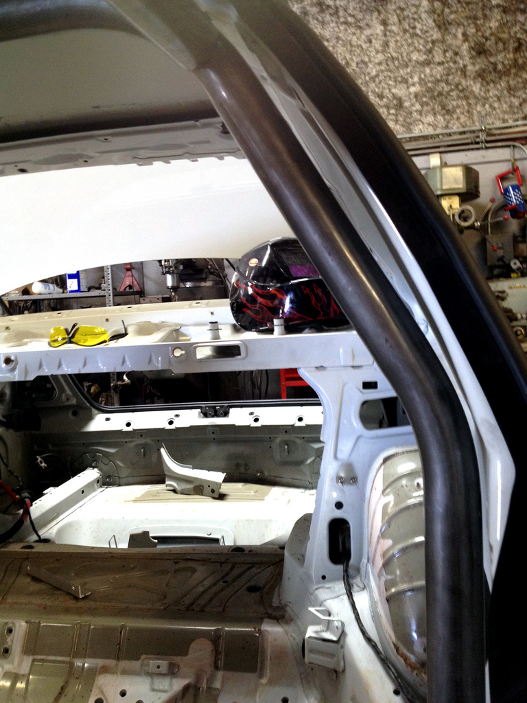

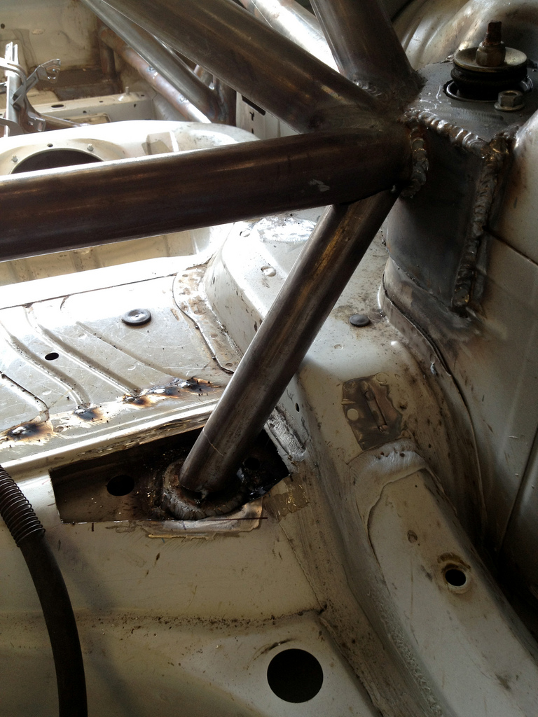

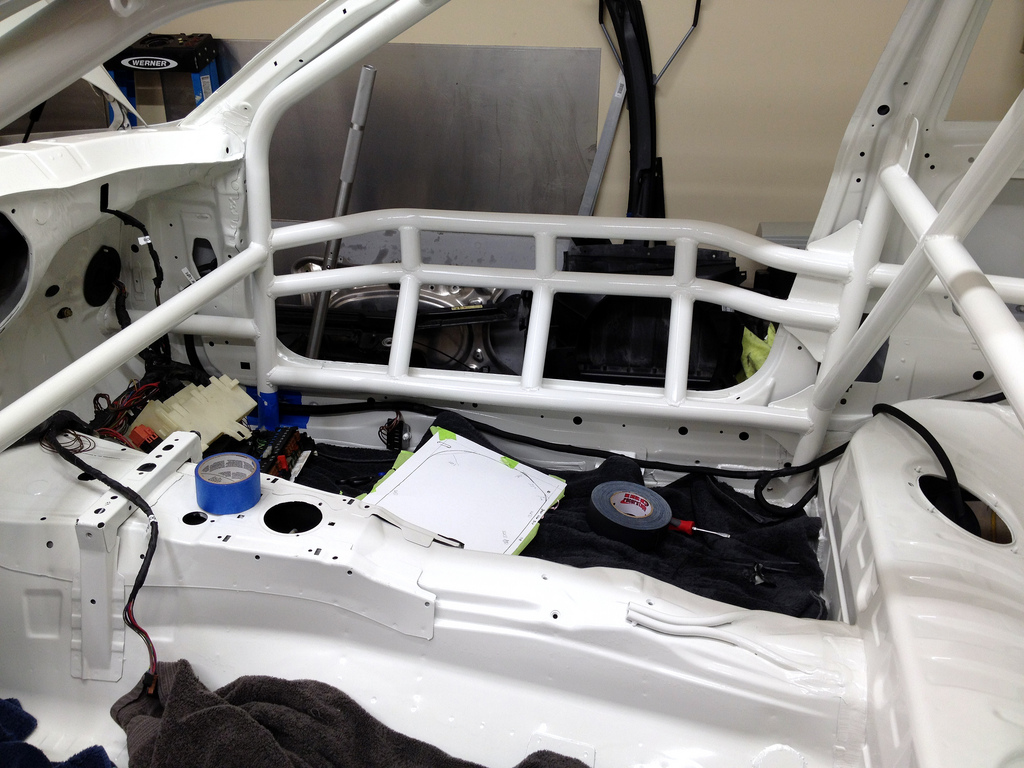

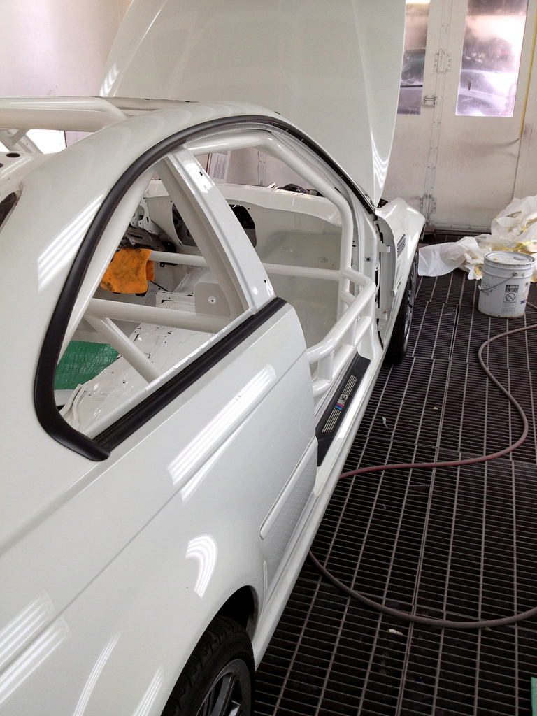

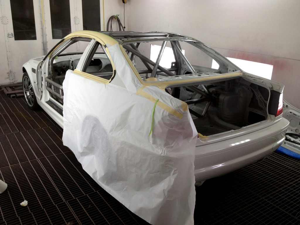

  • Roll cage was fabricated by Lucas Racing

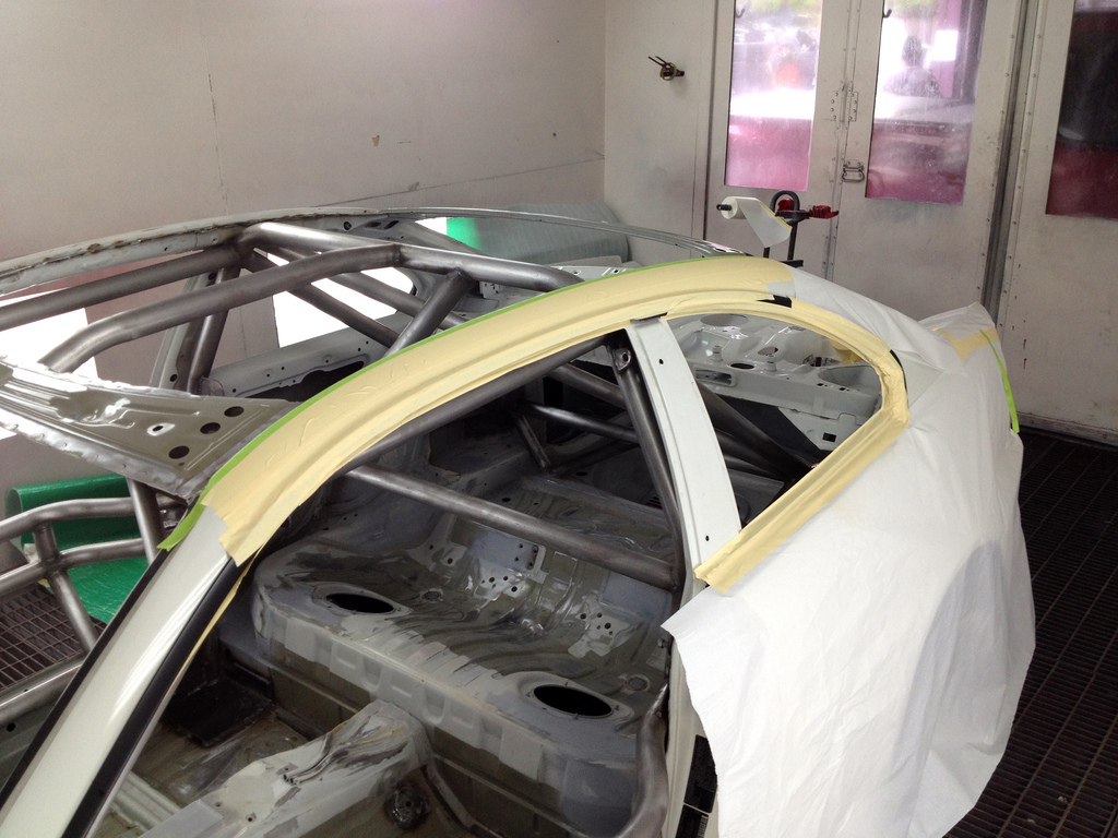

  • Interior paint & body was done by Richey Collision

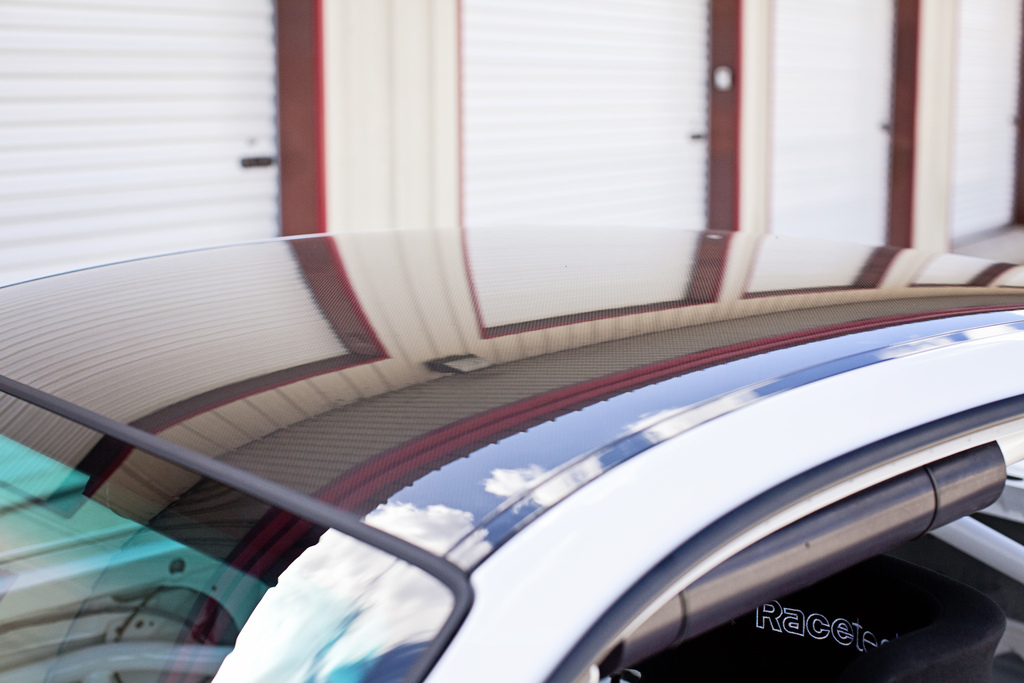

  • BMW CSL Carbon Fiber Roof
  • BMW OE Windshield

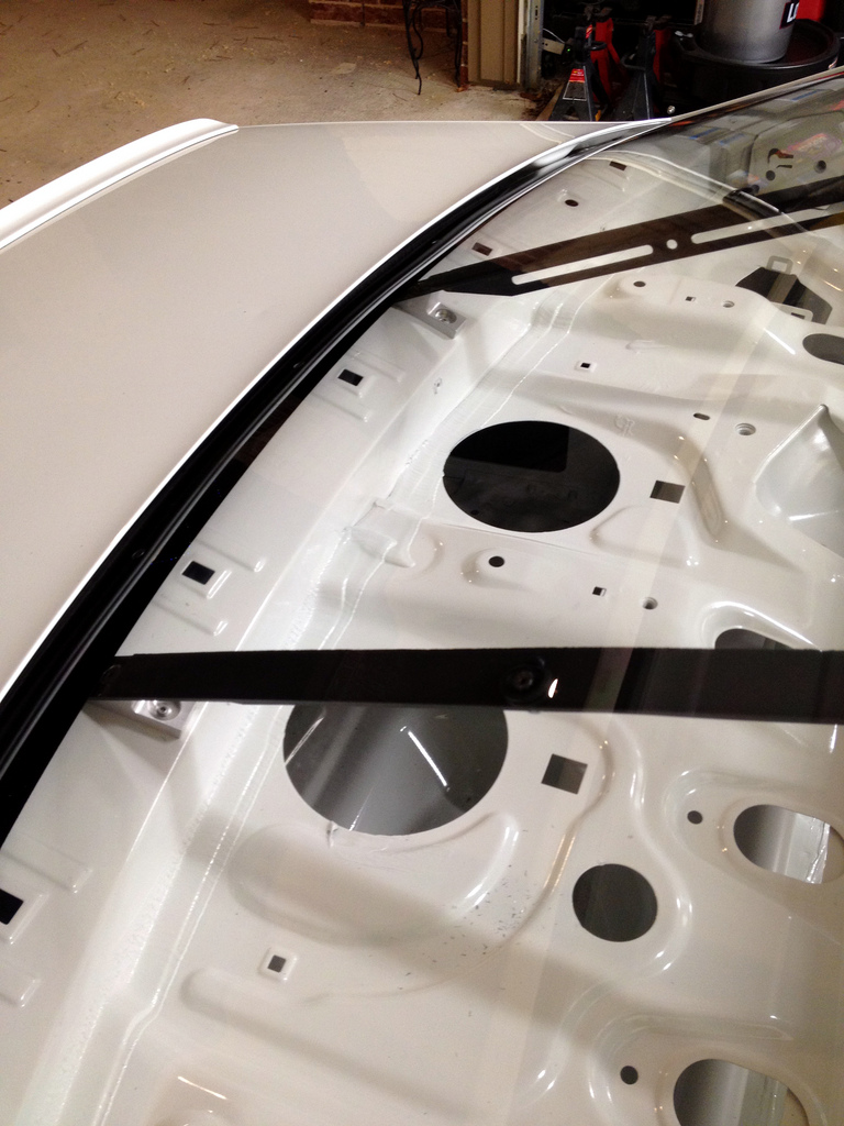

  • Five Star Bodies Polycarbonate Rear & Quarter Glass
  • Five Star Bodies Window Brace w/Custom Mounts

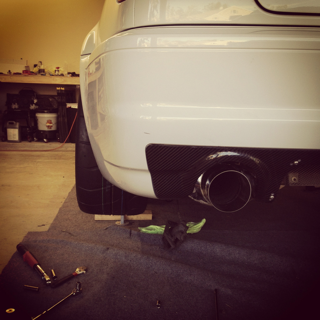

  • Bimmerworld Carbon Fiber Diffuser

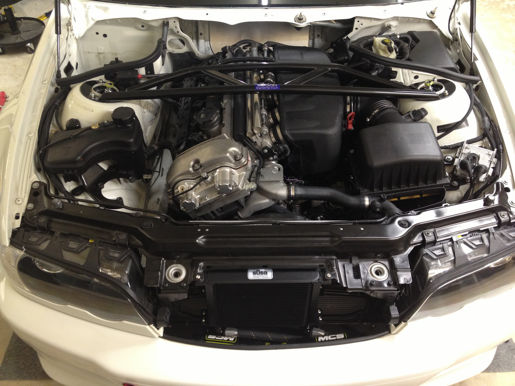

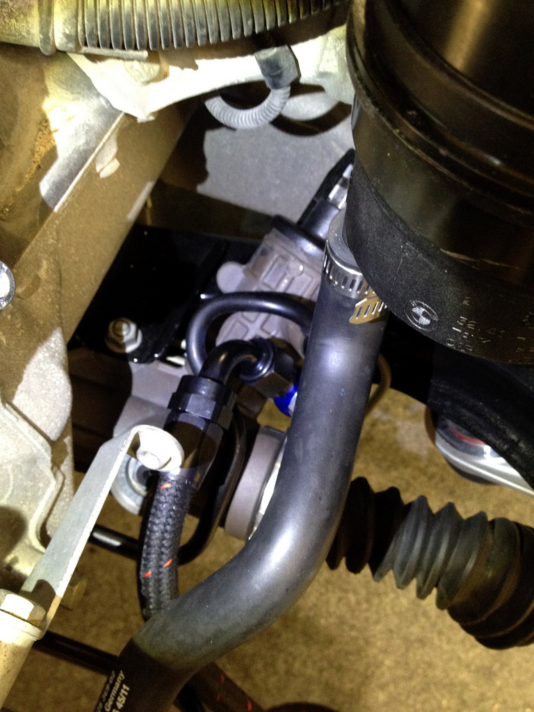

Engine/Performance

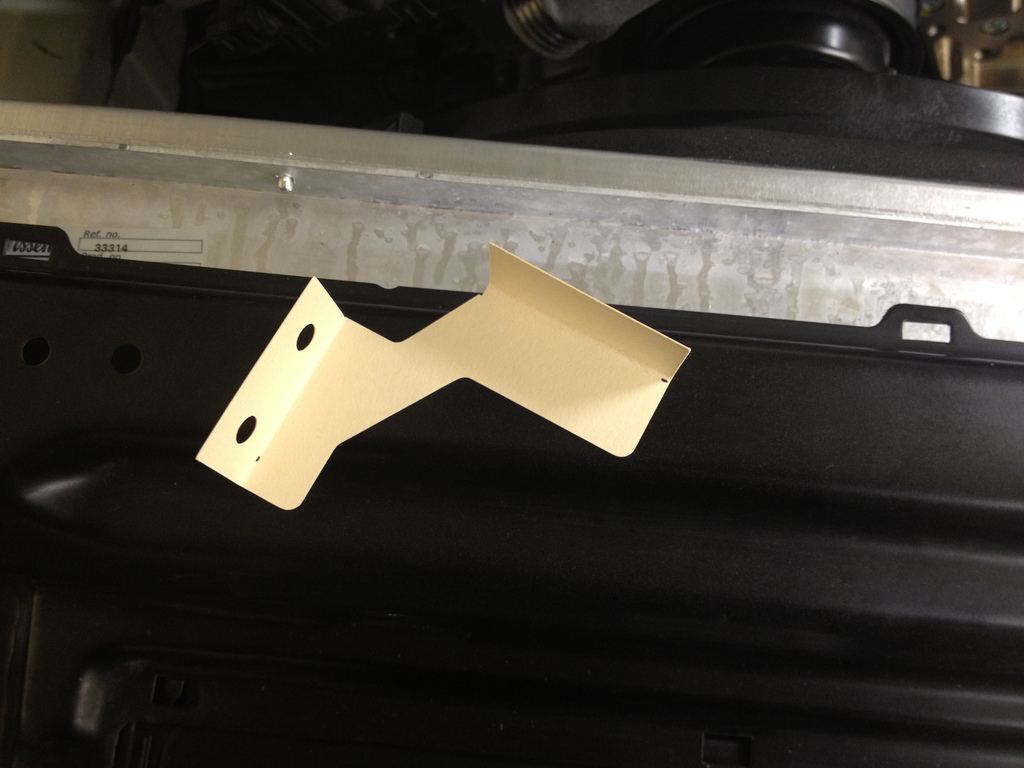

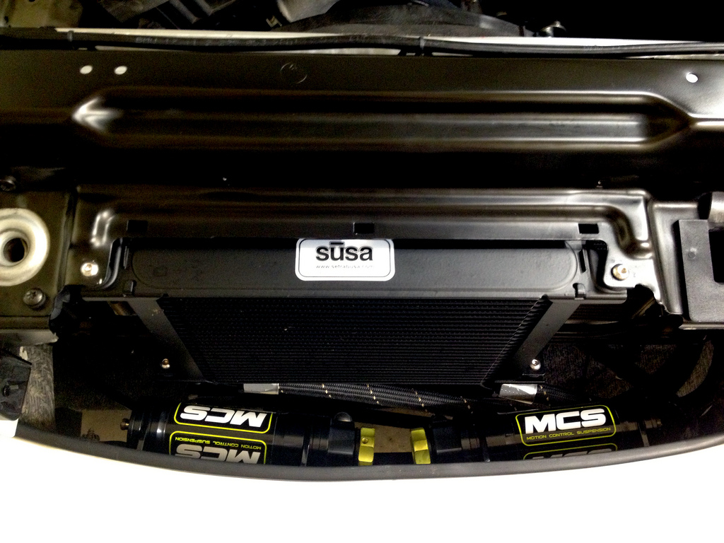

  • Zionsville E46M Competition Cooling Radiator w/SPAL Fan
  • BMW Motorsport Thermostat
  • VAC Billet Racing Oil Filter Housing
  • C&R Racing Remote Filter Housing w/Custom Mount

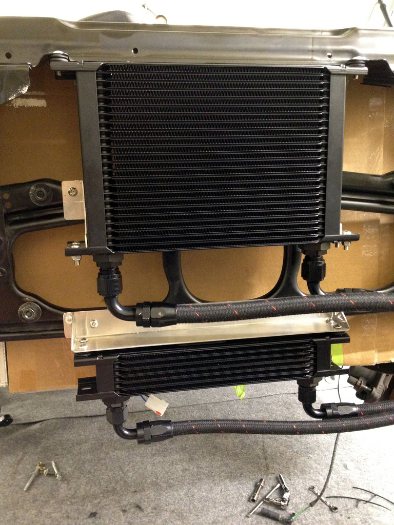

  • SETRAB Oil Cooler
  • SETRAB Power Steering Cooler
  • GoodRidge Oil Lines & AN Fittings

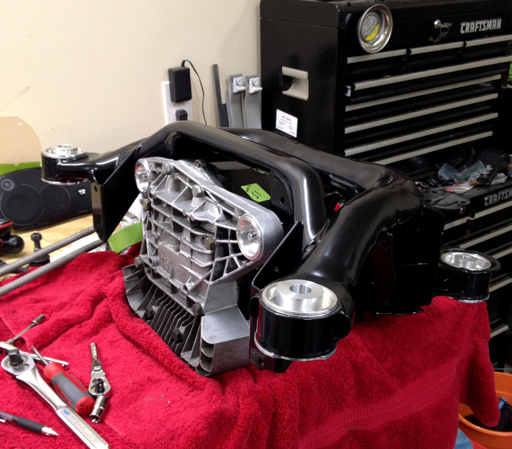

  • Turner Solid Aluminum Engine & Gearbox Mounts

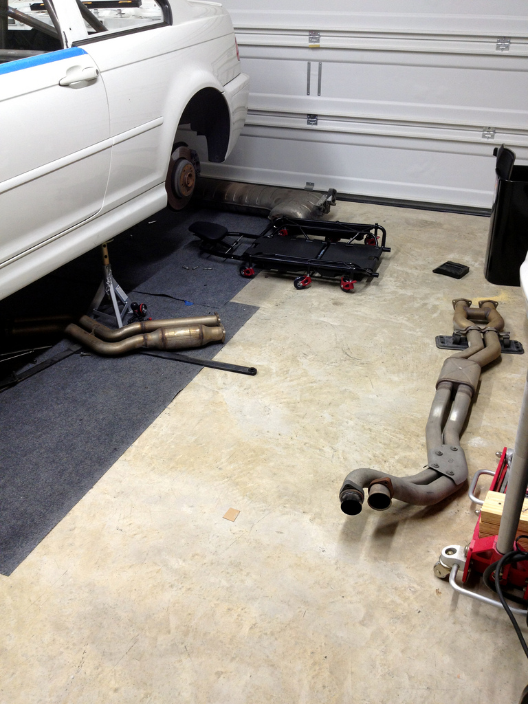

  • Bimmerworld Race Exhaust
  • Remote WIX Racing Filter
Suspension
  • MCS 2way Dampers w/Coil-Over Rear
  • Hyperco Coils
  • Hotchkis Sway Bars
  • Ground Control End Links
  • Turner Solid Aluminum Bushings & Spherical Bearings
  • Ground Control Control Arms
  • Turner Subframe Reinforcements F&R
  • Mason Engineering STB

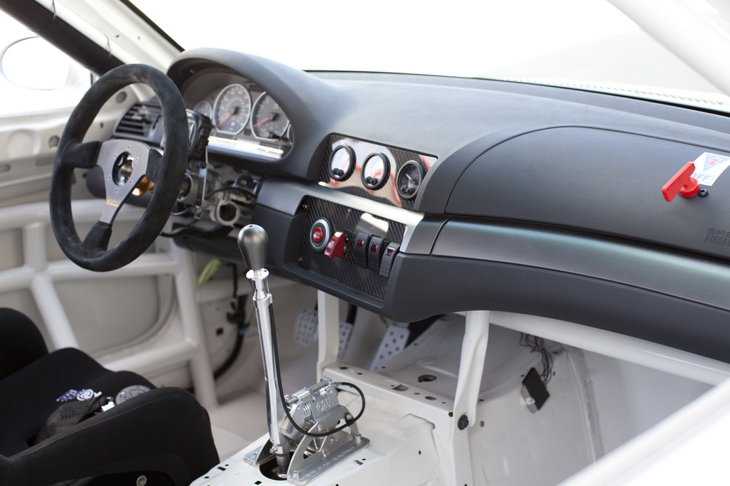

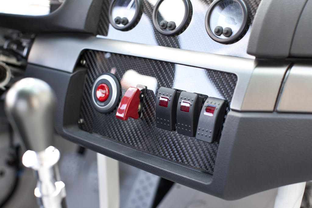

Interior
  • Custom Carbon Fiber Switch Panel
  • Push Button Start w/GTR Start Button
  • STACK Gauges
  • Custom AiM SOLO DL Mount
  • RaceTech Seat
  • SCHROTH Harness
  • CAE Ultra Shifter
  • VAC Seat Mounts

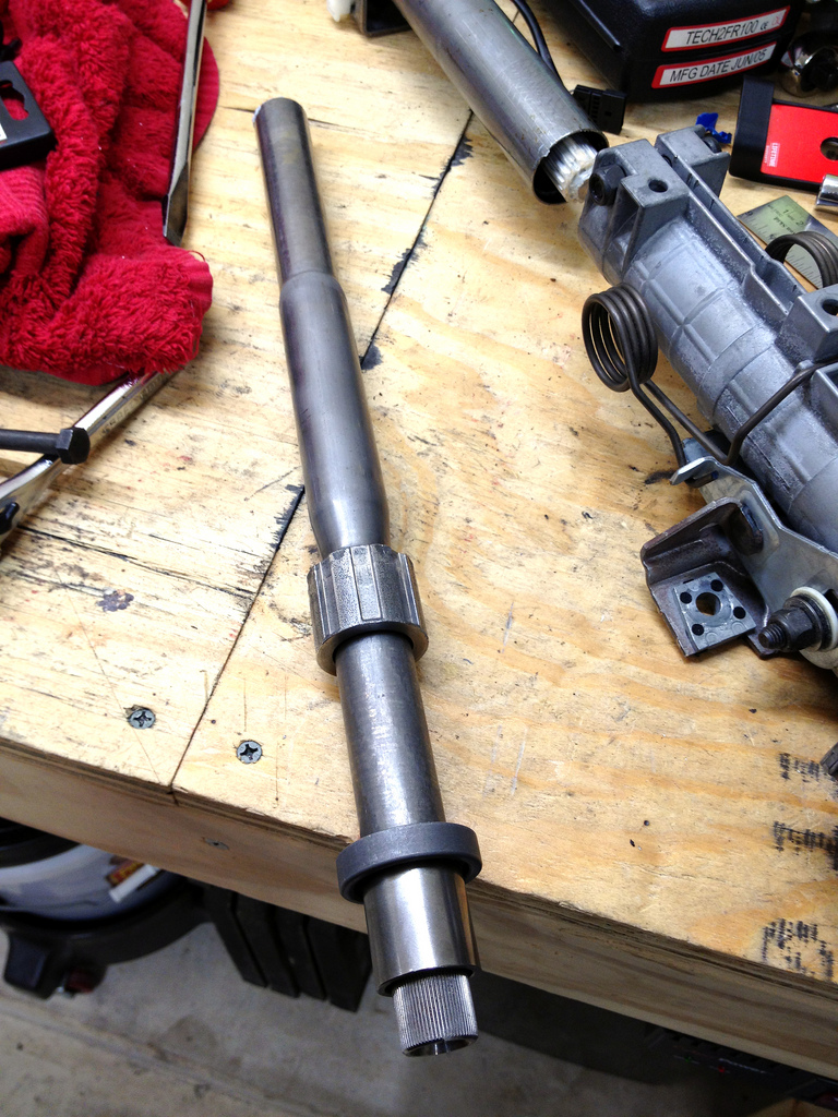

  • WorksBell Quick Release w/Machined/Pinned Steering Shaft
  • Sparco Steering Wheel
  • Mason Engineering Clutch Pedal
  • Turner Pedals
  • BSCI SFI 45.1 Padding

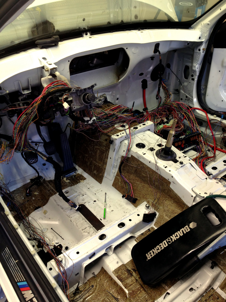

  • 4 Pole Battery Disconnect Switch
General

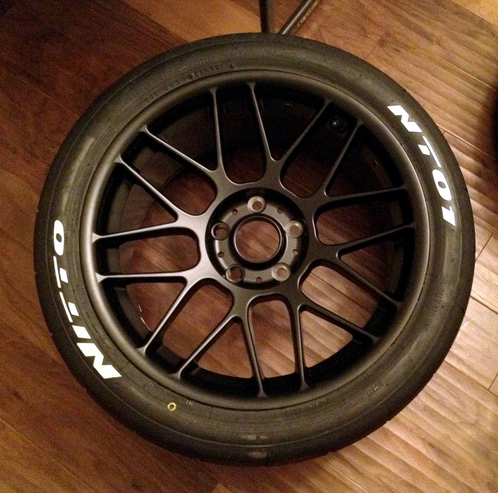

  • Apex Arc8 Wheels
  • StopTech ST40 Brakes w/Stainless Lines
  • Nitto NT01 Tires

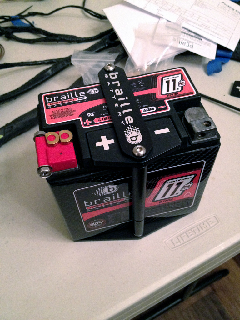

  • Braille Carbon Fiber Battery
  • Braille Battery Mount
  • PAINLESS Stranded Copper Battery Cable w/Monster Terminals
  • Techflex Braided Sleeving

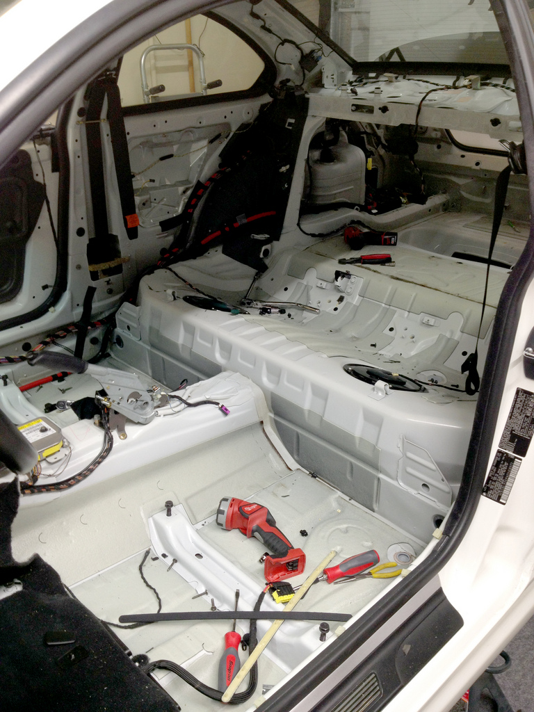

  • Heater Core Delete
  • CDV Delete
  • A/C Delete
  • Parking Brake Delete
  • Emissions Delete
  • Turner Nylon Tow Hooks
  • Turner 90mm Studs
  • Turner Spacers 5mm F 10mm Rear
  • Machined Rear Hubs to Clear Spacer
  • All new control arms, bolts, axles, seals, hoses etc
The car weighs 2819lbs (1278 kilos) with a half tank of fuel and no driver.

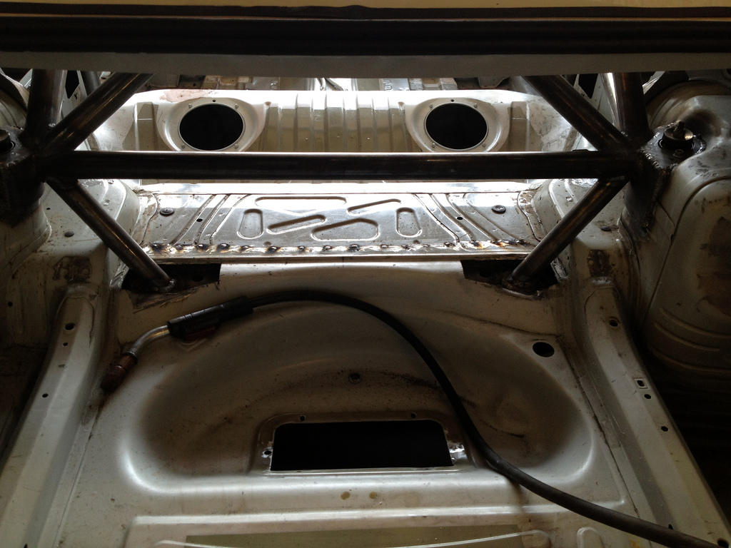

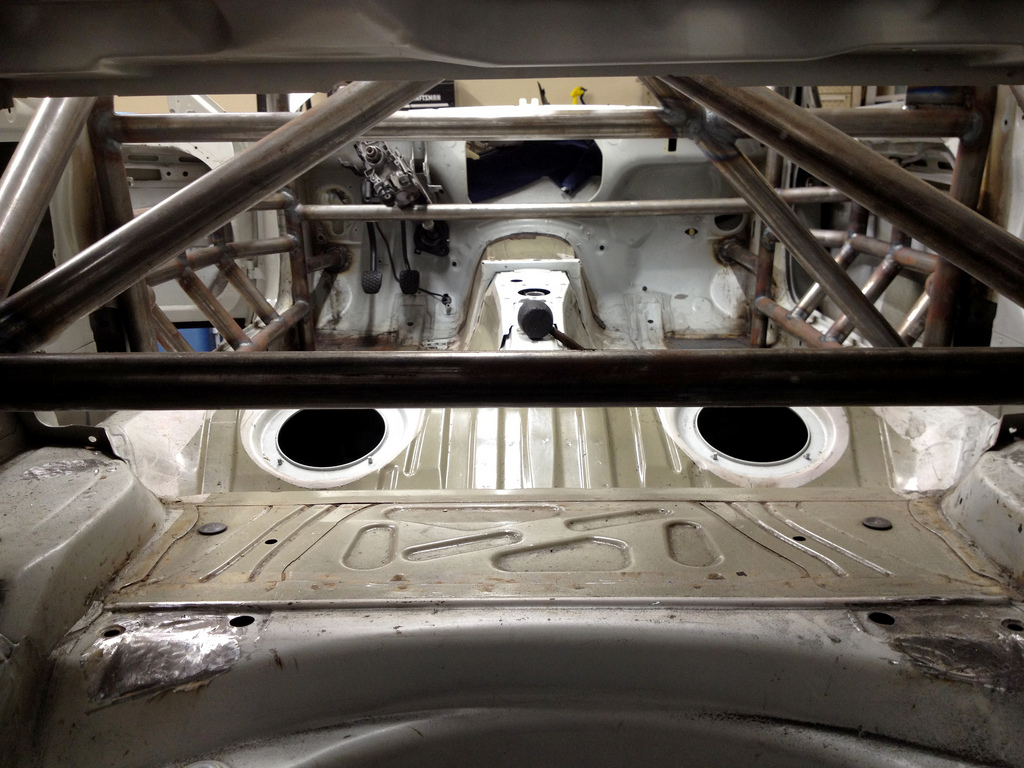

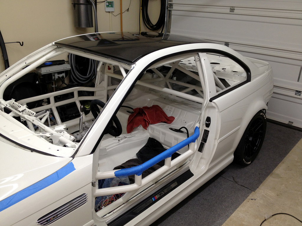

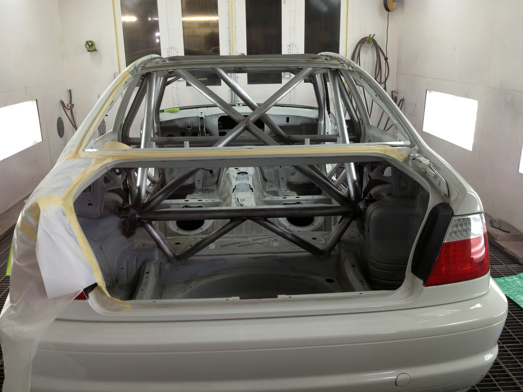

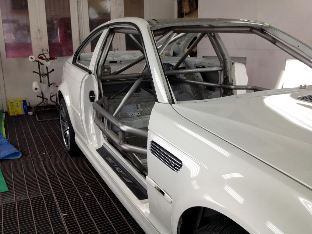

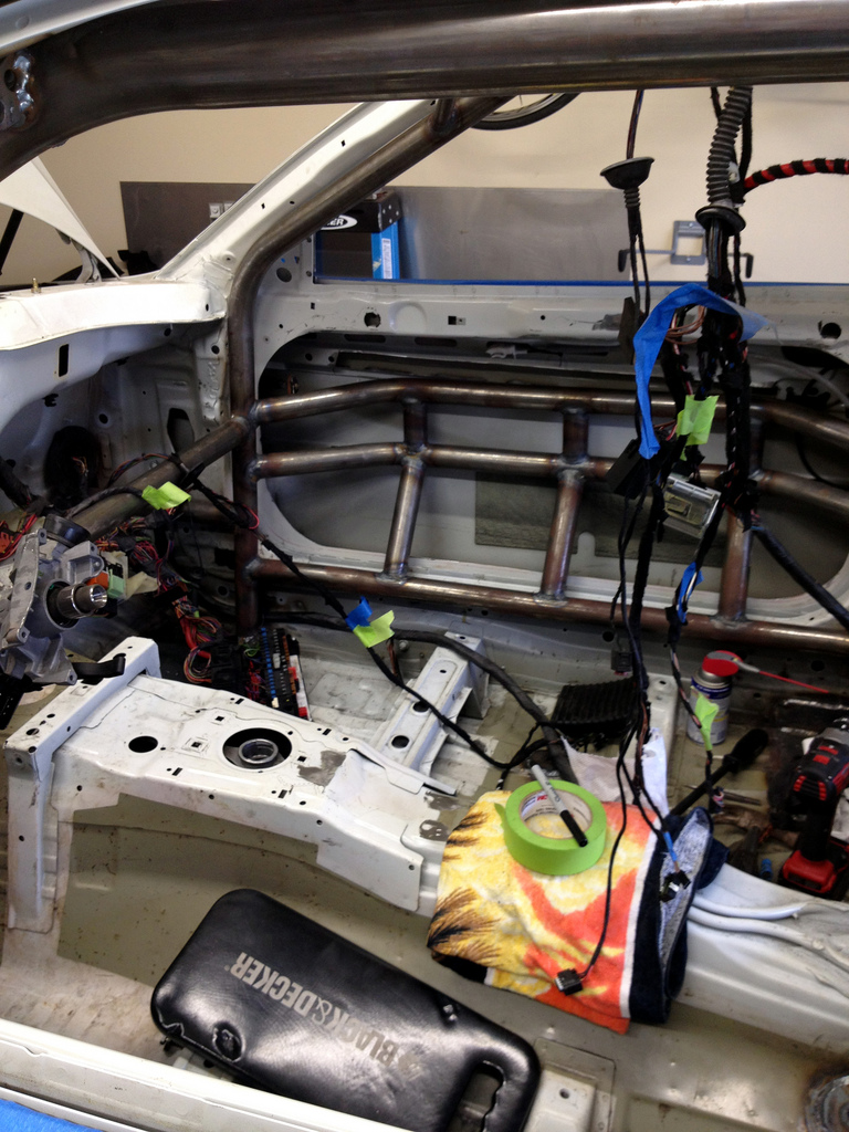

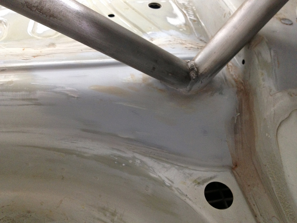

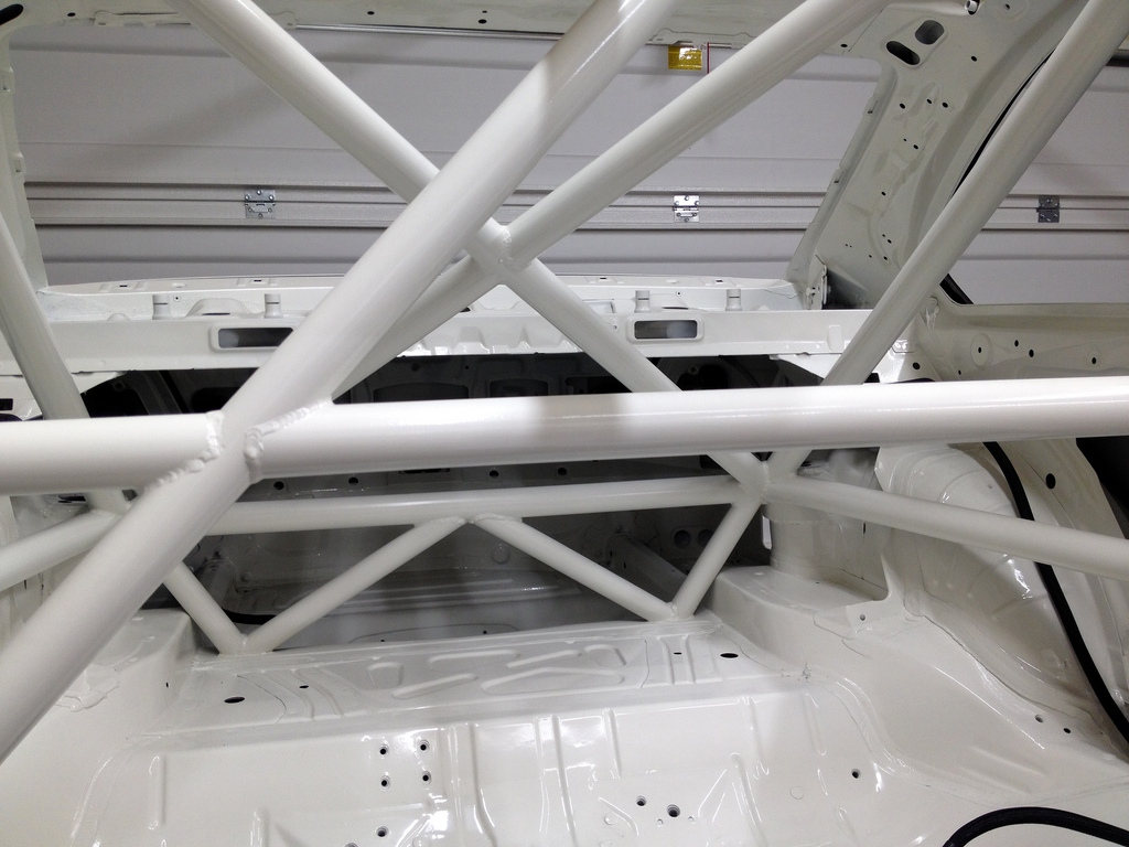

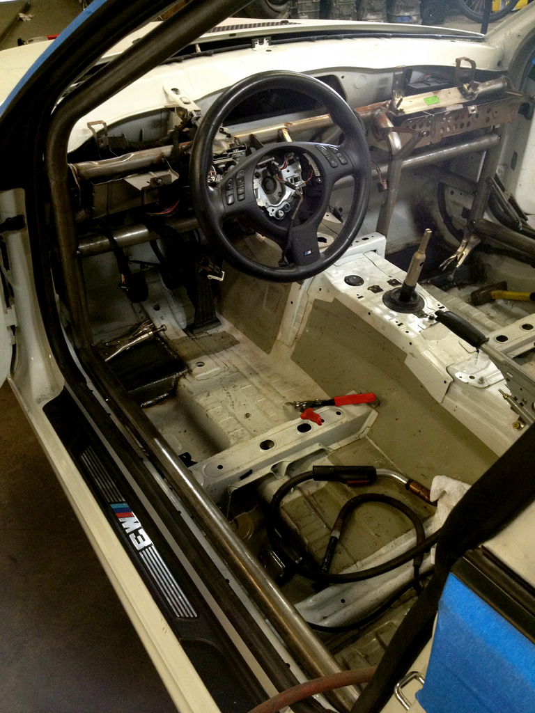

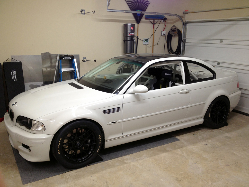

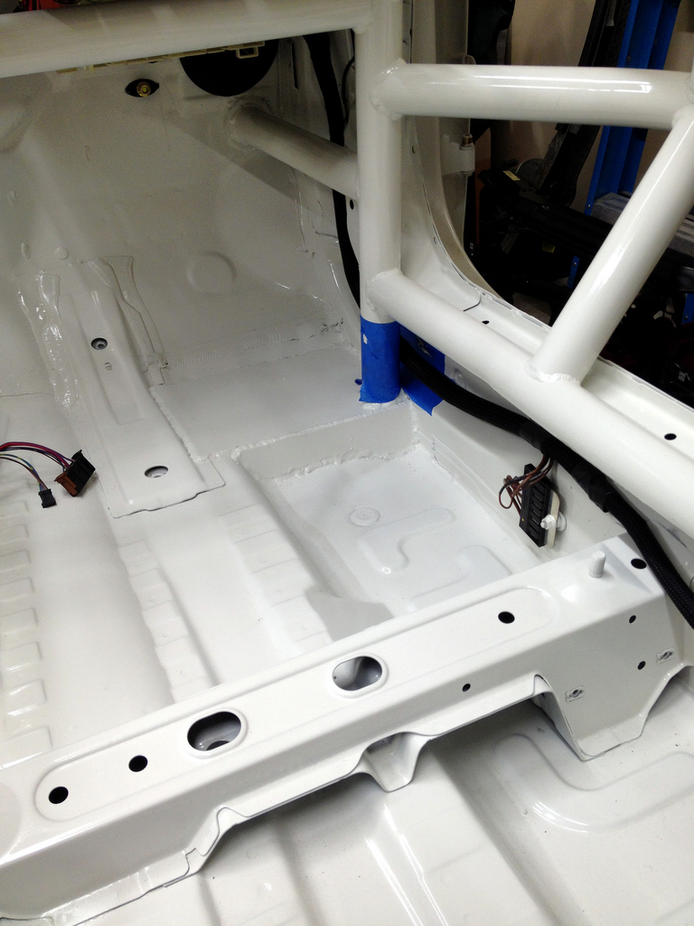

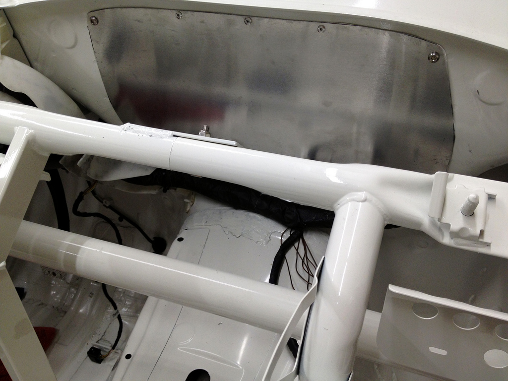

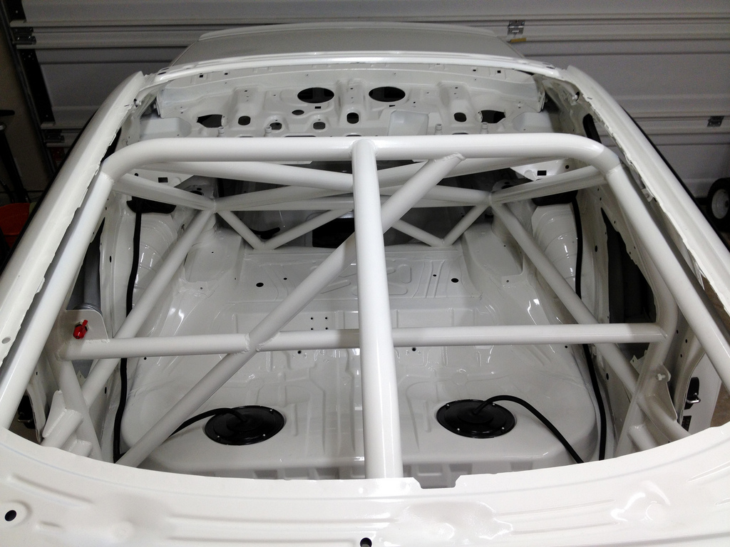

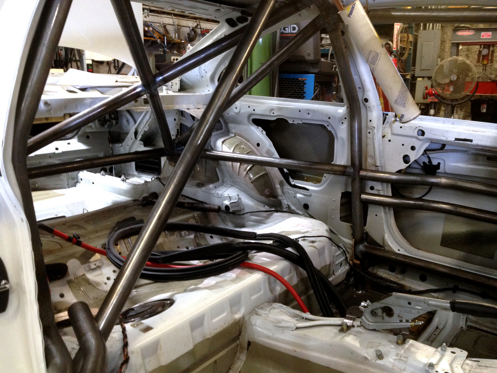

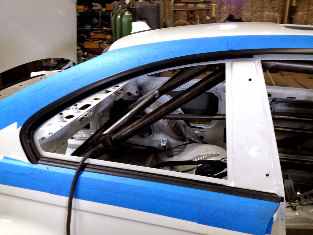

Jolie taf par contre l arceau qui rentre dans les portes énormes le renfort

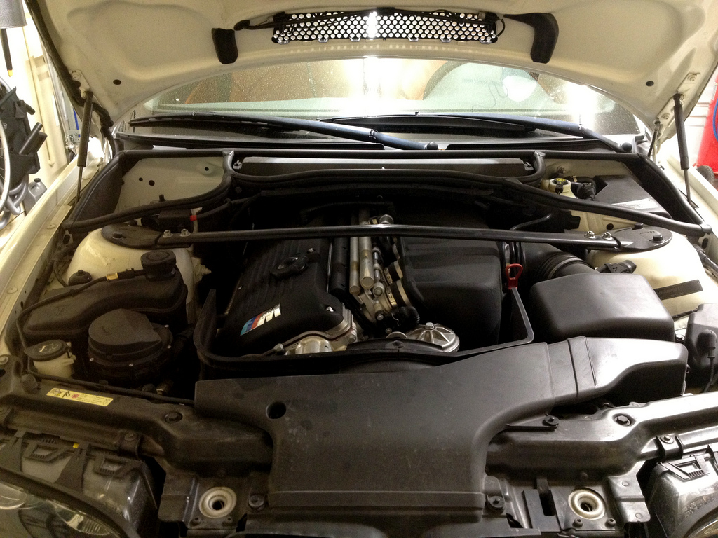

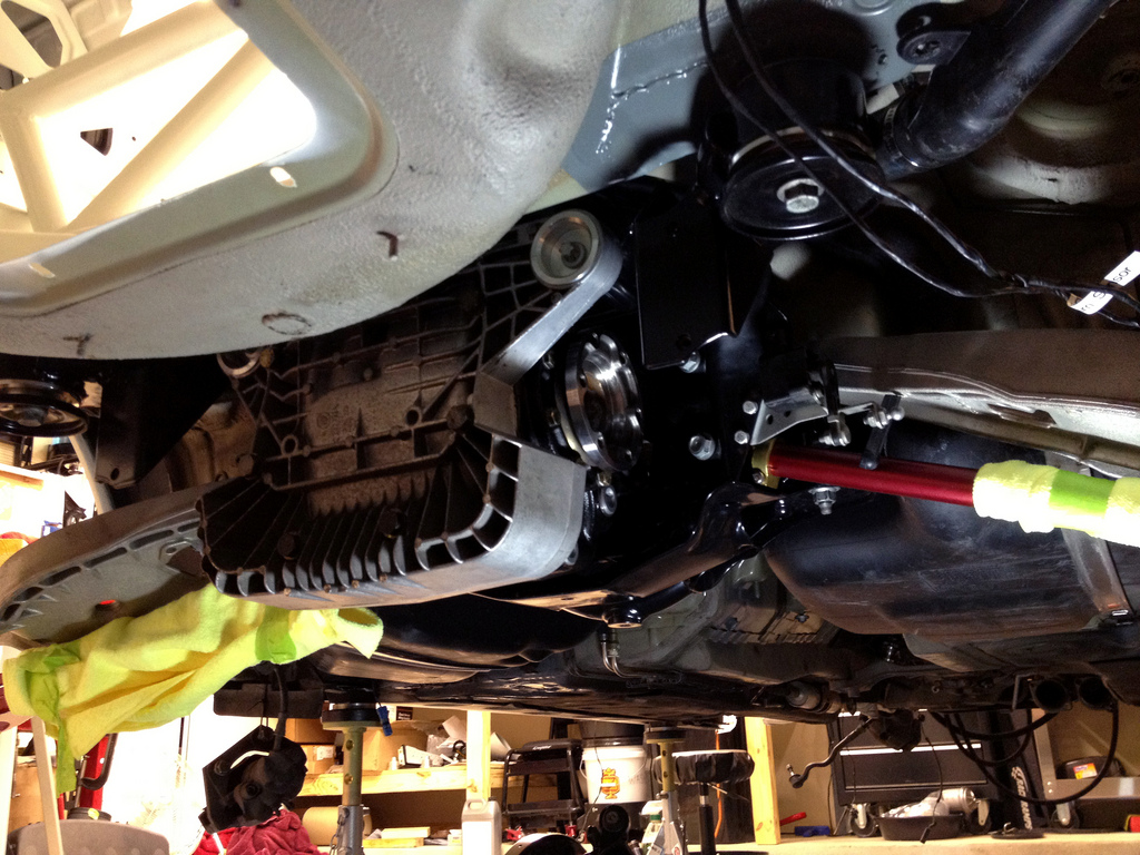

Sinon moteur stock même pas de nouveau coussinet ou autre ?
C'est un arceau typiquement US. Je pense que c'est homologué pour leurs circuits à partir d'un certain niveau. C'est le même genre d'arceau qu'en Stock Car.
POur le moteur...ça serait bien d'avoir le lien vers le forum d'origine.
