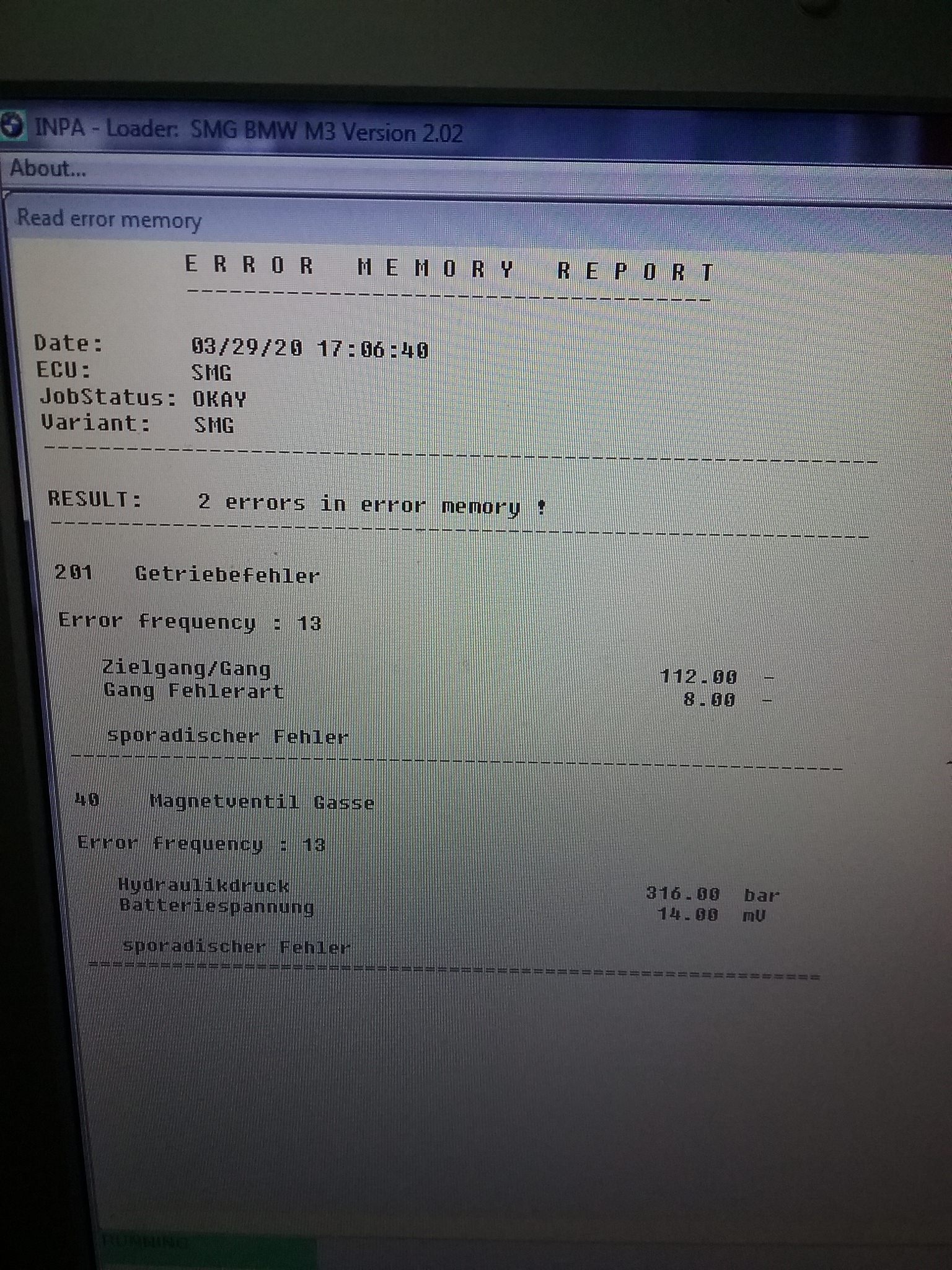

Very long story short. You only need an (old) laptop with RS232 port if you want full ADS = read all E36 modules.
But only a handful of modules need ADS and lucky for us, all important modules, like DME, SMG, GM4, all work with K-line only.

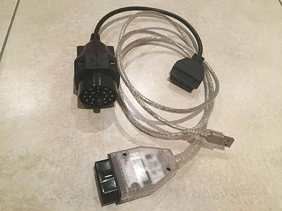

So you can use a cheap usb-obd-round connector setup and you can use any modern windows, either 32 or 64 bit.
I use a small Win10 tablet with USB cable to have a system that fits into my glovebox, just in case something with the SMG goes down (never happened, knock on wood).
I use INPA for quick fault code reading (much faster and easier than DIS) and only use DIS for SMG bleeding procédure.
I do the bleeding frequently and then with INPA reset clutch bitepoint and then you experience how SMG drives right from factory floor.
For full ADS diagnostics I have a GT1 yellowhead multiplexer, which today is overkill. But it works through ethernet connexion, so you can use anything with an RJ45 connector.

Pour ma part, j'avais monté à l'époque un PC sous XP avec INPA et le DIS. Je n'utilisais pas de port RS232 mais avec de l'USB et le câble suivant : "k+Dcan USB interface" et l'adaptateur 20 broches.
Mon PC est mort. J'ai essayé en Win7 32bits. INPA fonctionne mais je n'ai jamais réussi à faire fonctionner le DIS.
Maintenant je suis avec un PC sous Win10 64bits avec seulement INPA qui me permet de faire le basic (lecture d'erreurs et les effacer).

I use the same cable for all K-line modules.
DIS isn’t hard to get working, but needs to run in a virtual machine.
The software included with that cable has a one-click install procédure that installs INPA/DIS, etc.
